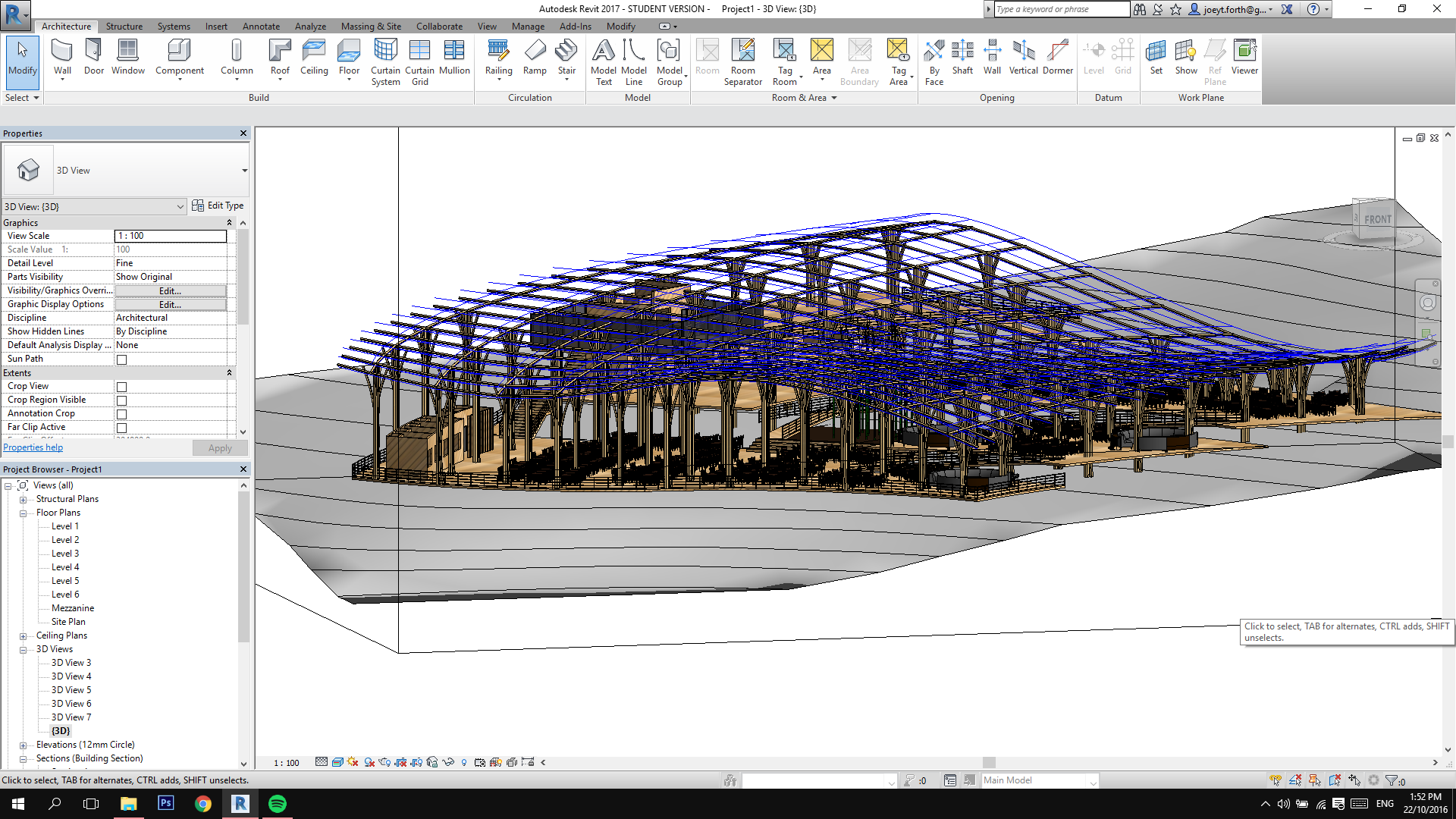

As mentioned, it is an organic roof form. Posted a screenshot here. Did a mass in place, divided surface with own curtain panel done in family pattern based.
Again, having troubles trying to cut a void through it. Have tried using the void tool while within the same edition when creating the solid mass.

I'm still trying to figure out but have some updates and observations. So here's what went down.
Scenario 1:
1. Created an in place mass
2. Divided surface
3. Chose a family pattern based which I've created, basically the 'beams' that you see
4. Fail to cut a void after editing.
Scenario 2:
2. Cut a void. It worked
3. Thereafter, divided my surface
4. Chose a family pattern based which I've created
5. Succeeded
Scenario 2 worked, but I am very reluctant to re do everything as I have used this model for consultation with tutors and have finally achieved a form which suits my conditions and requirements. Furthermore, I have spent time and effort locating my columns to a suitable span.
Is anyone able to point out something that I've been missing, or is it simply that Revit does not allow the processes stated in Scenario 1?

When revit divides a surface it creates a new element for that surface which hosts the divisions. It is likely that when you were trying to cut the geometry with the void you were trying to cut the divided surface element and not the surface itself. You need to tab select the proper element for this to work in the first scenario
