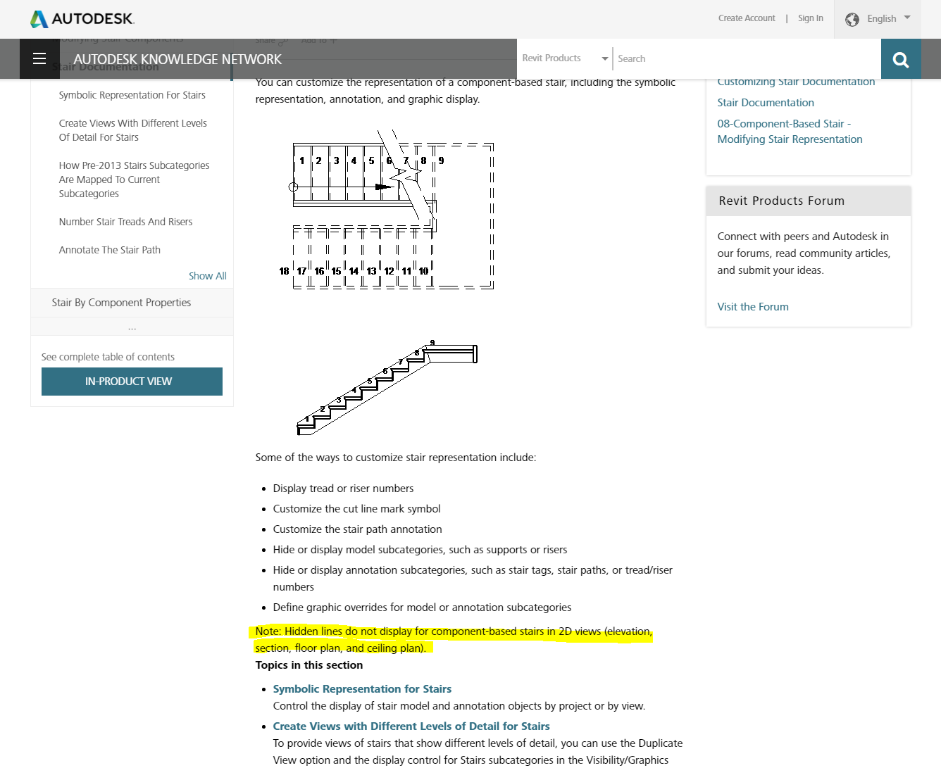

(about Show Hidden Lines tool) Stair by sketch works as expected, not possible though for the component stair (Autodesk Knowledge). However, I noticed when the Far Clip Offset cuts the stair, the stringer shows through, not the treads/risers though???

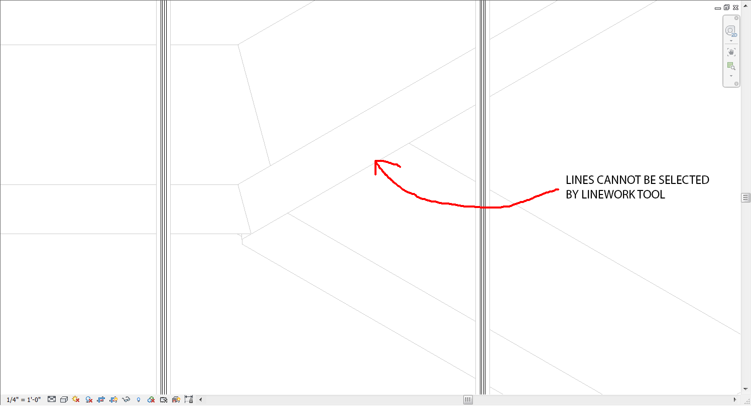

I'm trying to affect the stringers, not the treads and risers. Those do work as expected. The stair stringers cannot, in any way, be snapped to or modified by either drawing additional lines over the top, or by using the linework tool. I'm working in 2016, so maybe Autodesk resolved this glitch in 2017? I still do not have a resolution unless someone else can confirm that this functionality does not exist in 2016. Thanks.

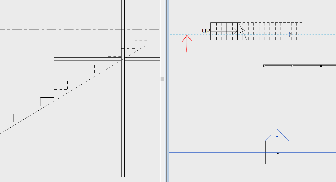

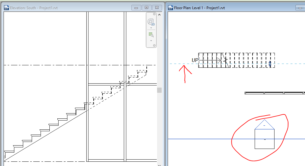

Must be some glitch on your end. In 2016 R2 show hidden lines tool works as I described in my previous post, except risers and treads (and stringer) are visible when far clip offset cuts through the stair (see pic). In 2017.1 only stringer is visible. Snapping and linework tool work as expected in both versions. Have you tried in a new project with default template?

Yeah this doesn't work here. I am using a component stair and the stronger component is a c-channel type running along the outside (steel pan stair). This object is simply unrecognizable by the linework tool. I don't think this is a local issue. It appears systemic.
