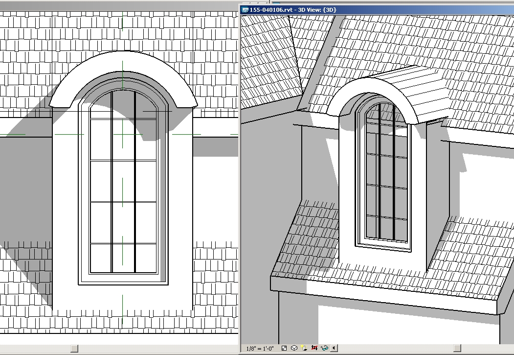

I created this roof by extrusion; specified a ref planel plane created in plan (a vertical plane) as the workplane. When I specify a 2 cut plumb fascia, it cuts it, not vertically but horiznontally, look at the ends of the arch. Same result with square cut fascia. Anyone know why?

when specifing the the 2-cut plumb and 2 cut square, you have to also specify a fascia depth

This occurs no matter what fascia depth is spec'd. In fact, that setting only chages the dimension of the horizonal face facing downward.
arched roof edge
