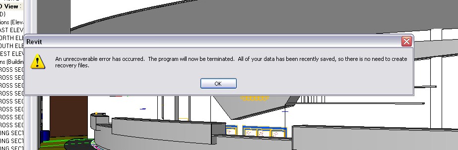

I have someone with the same continuous error. He says it happens every hour or so. No reason at all.
Here is a screenshot of the error... we've tried 'auditing' as above but still receive the error.

Just to update on the situation this was a solution i was given. I will let you know if this fixed the problem or not.
"This is most likely caused by the graphics hardware on the system, and or the drivers.
Revit is sensitive to hardware and driver quality and works best with workstation class hardware.  More information on your current setup would be needed to determine whether this is an issue, but at the very least obtain the latest driver software for your graphics hardware.
Also, heat build up inside the machine can cause unpredictable errors such as this one, also due to the graphics system struggling under load.  Make sure the machine is clean internally as dust builds up quickly and all fans are operational.  Heatsinks and cooling mechanisms should also be cleaned so they operate efficiently.  You should engage the services of a competent computer technician to check and clean these components, plus install all the latest drivers for your installed hardware."
