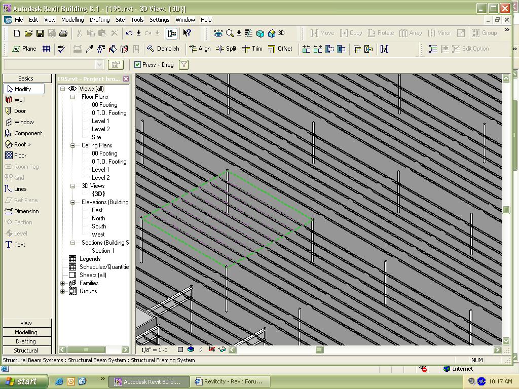

This is probably a simple question, but i am trying to make my beam system slope in one direction. I have tried a number of things with no success. As it sits now, i need to slope from the front of the building at (with an elevation of 24'-5"Winking to the back of the building (with an elevation of 16'-11"Winking over a length of 343'-3". I have tried to create a reference plane in hopes that I could use it somehow, but haven't figured out the benefits of that, yet. I also have to cut off my columns (which are all at the same height right now). Can anyone give me some advice on this?

hi there i have only recently begun using structure, and thought it a good idea to try after reading lots of posts about it. i put purlins into rooves, and it has worked fine. but i suspect your issue is that you have to place the structural element after creating the reference plane. and best to give the plane a name, so you can set the work plane for the structural items. this may be too simple an answer, and the experts will certainly tell us all the best way!

Draw the reference plane in section/elevation at the appropriate angle. (you can name it if you want sometimes helps for finding it later) Select structural Beam System. You'll be prompted to pick a work plane. Choose pick plane and select the reference plane, or, if you named it just pick from the drop down list. You are then prompted to go to a plan view. Draw the shaped of your beam system and select your beam type and spacing. There you go... HTH.

Thanks, naming the reference plane was the key. I have the whole structure built now, but in 3D, the beams that served as the "supports" do not show up. Each bay is a "beam system", and i can't see my girders. This is a problem because i will need to see the exposed structure. Is there some way to explode the "system" and turn it back into individual components? Thanks for all your help!

mr spot will have a better answer for sure, but have you tried changing the detail level of your view. you see, revit has settings that make structure look like lines in 'course' detail level.

You can edit individual beams in a beam system by using your tab key to select the individual beam then unpinning it. This will allow you to move it independantly of the system. As for the supporting beams I don't think that they should be created as a beam system to begin with (you can't actually "explode a beam system"Winking. Draw these beams individually. If your other beams are to be support on top of these i'd select the underside face of the beam system to be the workplane then draw the supports in. HTH.

I didn't create the supporting beams as a beam system, but i used them to create the beam system. The tutorial i referenced said to set up columns and then girders and select "beam system" and "pick supports" and select the girders and joists that will make up each bay. I did that and for a while i could still see all of the components. However later in the day, when i would switch to 3d mode, i could no longer see the girders and joists at the boundary of the beam system bay. Only when i hover over it with my cursor, do i get a dashed green line where they used to be. I tried unpinning them, but it only makes the ones i can already see, moveable. I don't necessarily need to move the beams, i just want them visible in a three dimensional view. Do you think i need to start all over?

The green dashed line is just your beam system. Your beams/girders are either gone or turned off... Check your visibility settings to make sure all structural elements are turned on in your 3D view. If they are definitely gone, it will be quicker to just recreate them. HTH.
