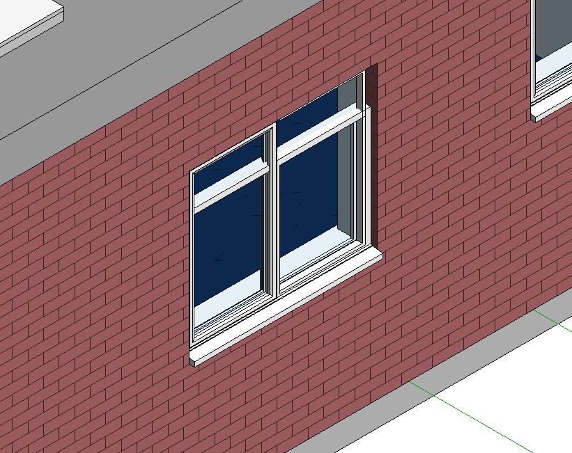

the window family called Windows_Dbl_Plain 1360 x 1210 are not displaying properly in Revit 2016.
The actual family is ok, and they display ok in plan view but when in elevation and 3d display as seen in the attached image.
Can anyone help with this please ?

i think its a problem in the family itself , if you can post the family source it will be better , and if the family is parametric ..... does changing sizes corrupt the family (is it a parameters issue) . anyway you will have to go inside the family and fix it , look at the reference planes and which reference plane is that frame locked onto.

It is likely that in the family the outer frame is a sweep and the top sketch line is simply not locked to the top reference plane controlling the height

Thanks for the replies.
Not getting what your on about, still new to revit etc
Just added the family file.
