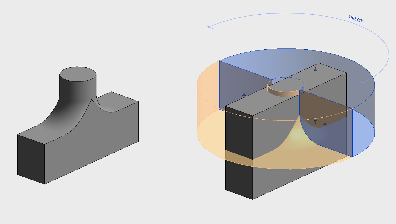

Hello there,
I have posted it here a month ago and I can't get the answer and solve this problem.
So I post it here again. Please can you anyone help me solve this problem?
Please see dimensions in the attachment.
Please see what I did to draw it in my video here:
https://www.youtube.com/watch?v=nr0k79NwmFA
Thank you for your assistance and time.
Regards,Bogumil

I cant see the video now but,.....is your void the same category as the solid?

Fri, Oct 14, 2016 at 6:16:36 PM | Vold element can't accept to cut solid on the edge
pijpiwo
pijpiwo Avatar
Joined: Fri, Sep 3, 2010
0 Posts
5 Stars: 25 Votes
It looks like Revit doesn’t like this condition too much. Instead, create simple rectangular extrusion and use two void revolves (2 x 180 deg) to cut the solid.
Sat, Oct 15, 2016 at 2:49:40 AM | Vold element can't accept to cut solid on the edge
Bogumil
Joined: Mon, Aug 11, 2014
0 Posts
I test it and it went successful. You are right that Revit dislike my condition. Next time I know better who Revit is. Thank you VERY MUCH and your time :-)

#pijpiwo - My method went successful but I wanted to try to copy your method way and it looks not successful and very strange. Please watch this video and see my side of what I do and follow your method. Let me know what it causes.

Sun, Oct 16, 2016 at 3:27:57 PM | Vold element can't accept to cut solid on the edge
pijpiwo
pijpiwo Avatar
0 Posts
5 Stars: 25 Votes
360 deg void revolve will not work? Look at my picture and read the post again - two separate void revolves, each at 180 deg (90-270 and -90-90 or 270-90).
EDIT: The trick is to use two voids.
