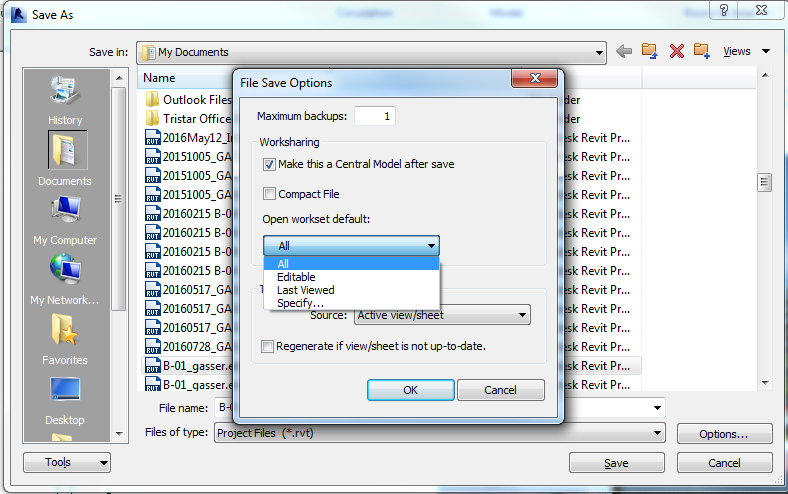

when you are saving the file as central you get 4 option to set whats the default workset as in the attachment , the usual is all , there is an option to only open the editable worksets , or the last viewed , and the specify which asks you each time you open the file what worksets you want to be opened and i think thats your best option to achieve what you want .
and here is the same part from the revit help :
