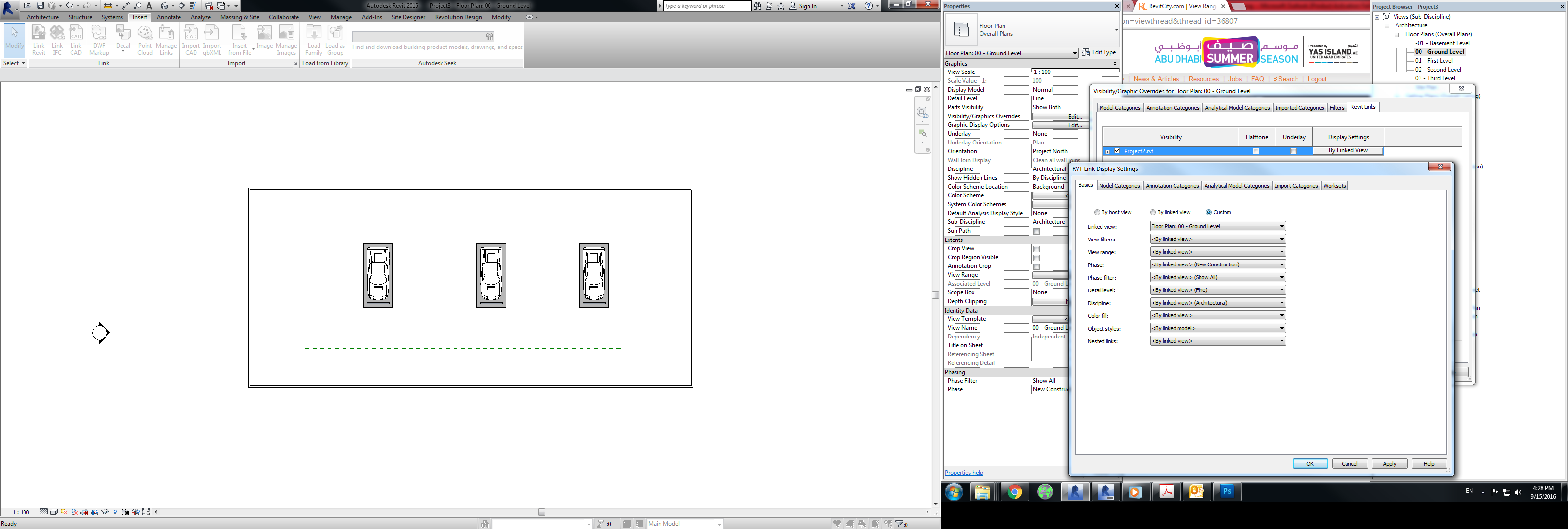

Good day!
I have problem:
I fixed view in my file with View Range annd Pan Region. When I link this file into another file and fix visibility linked file by linked view, Revit ignores Plan Region. How can I fix visibility linked file with plan region in it?
Thu, Sep 15, 2016 at 7:34:58 AM | View Range ignore Plan Region in linked files
Elnazer2
Joined: Thu, Feb 18, 2016
0 Posts
4 Stars: 5 Votes
i just tried it and it works fine , just make sure you are setting the link as by linked view and make sure you are linking the right view and if you are setting the revit link to custom make sure the view range is set to by linked view.
