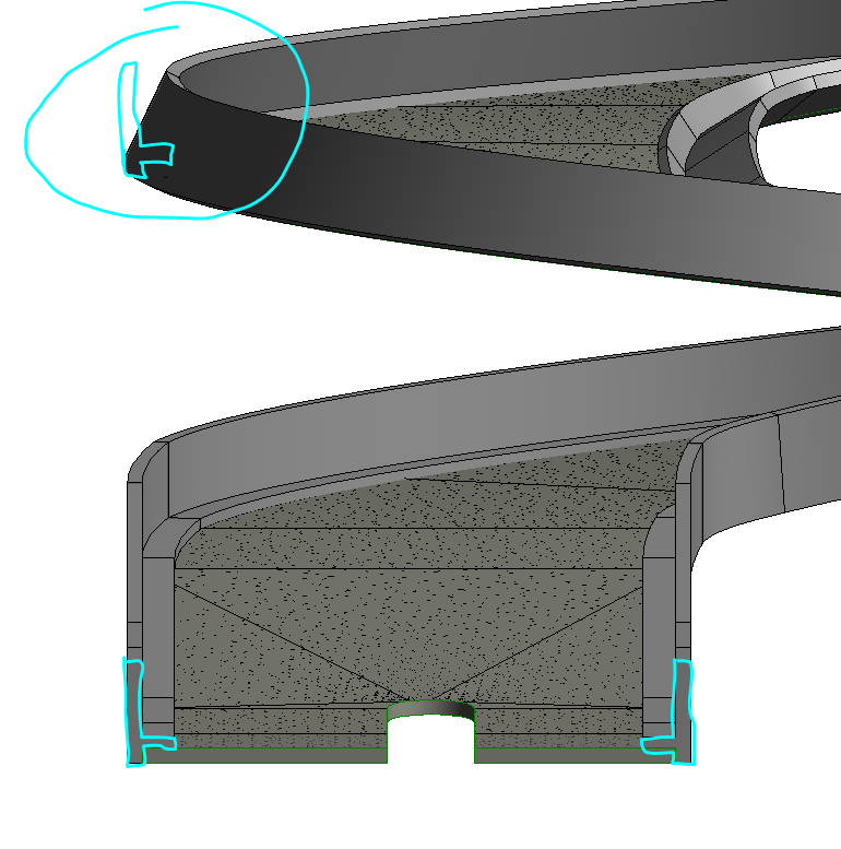

Can someone help me with what I am trying to achieve here? I want my profile to be vertical throught the sweep. Is there a a way to do this?

Ya I tried that. Problem is its an ellipse and a helical. When I select the ramp (which is a floor) as the host it stays horizontal and does not follow the ramp. I also exported to sketchup and tried it with the follow me command and it ends up looking the exact same.
Any other ideas?

It looks like you created your “ramp” with the Floor tool and created a cross-slope using the Modify Sub-Elements tool. In that case, I think your sweep path for the “wall” is following those cross-sloped floor edges – placing your wall perpendicular to those planes. Couldn’t you correct by using Modify Sub Elements again to “level out” a surface onto which to place your “vertical” wall? One other thought: perhaps you could cross-purpose the Slab Edge tool to accomplish what you are trying to do?
