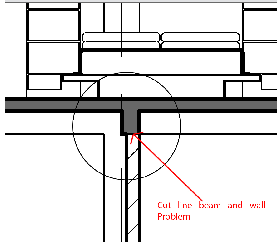

I have a problem with cutting wall and beam. How can i show the bolder line of beam when i use cut tool in revit!
Thank you for your help!
147058_problem_with_cut_beam_and_wall.jpg147058_problem_with_cut_beam_and_wall.jpg147058_problem_with_cut_beam_and_wall.jpg147058_problem_with_cut_beam_and_wall.jpg

Revit by default only shows a joining line because this is not an exterior line.   Use the linework tool.
