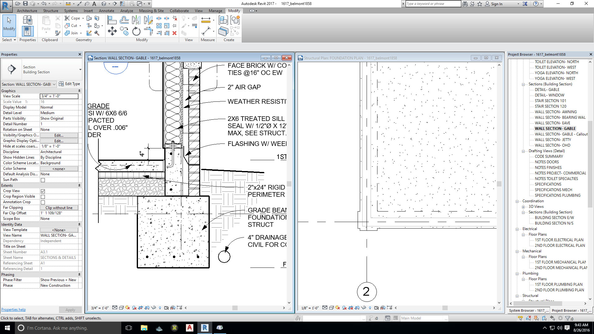

I'm a Revit newbie, things are going well as I'm transitioning from years of autocad, but I have a quickie that has me stumped and someone out there might know. I'm modeling a foundation and I'm using a wall-attached foundation. On a few places, the building has brick veneer, and I'd like the foundation to be centered under the structural core, not the overall wall thickness. I've changed the foundation's eccentricity to -3", which gets it centered how i want it, but then in plan the corners don't clean up correctly. See attached shreenshot. What am I missing? thanks...
Revit 2017, w/ MEP
