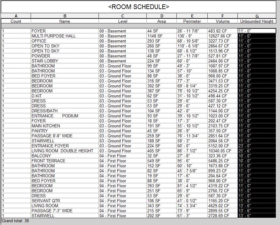

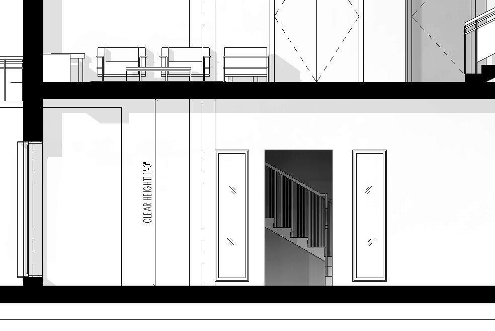

Hi,
I am having difficulty understanding how can I add the clear height (not the ceiling height but the height from top of one slab till the bottom of the slab above, shown in the image attached) in a room tag. If I can somehow add the Un-bounded room height in the tag, it'll be perfect.
I did manage to put the Unbounded room height in the Room Schedule (highlighted black in attached schedule), just need the same in the room tag.
Any help will be appreciated.
Thanks!

As long as that is a shared parameter, that you can include on your tag, that should not be a problem.

Hi, Thanks for the reply, If you can tell me the steps to do that, it'll be really helpful. As I am a starter, I do not have the clear understanding of shared parameters. I have tried looking at a lot of tutorials, but none of them addressed the problem at hand.
