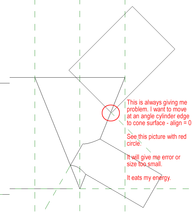

I need your help with family creation. I am tiring with message pop, "Element is too small on screen".
I am not good writing in English about direction, description, etc. I create the picture to show you what I went through.
See below attachment and I hope you got it.
I study on course about development. I use Revit helps me what it looks when I have done it. I follow this course from this link:
http://www.thedraughtingacademy.co.za/Library/Study_Material/Theory%20Course%20Manuals/General%20Draughting/Content/GD_05_038-A.htm
I hope anyone help me with this problem or tip me why it causes. I did it many times with other fiqures in book. It looks like Revit dislike touch each other but how can I make it to 0 (each other).
Please let me know and thank you for your time.
Regards,Bogumil

if i understood you well you want to make sure both lines ends at the same point , and when you are moving those lines from that current location you get that error element is too small on screen , so what i would do is moving the line ( Object ) far in any direction from that point and then move the line from the intended end point to the other end point - to do easily you will need to use a snap override to the end point .

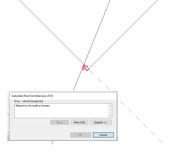

The problem you are having seems to be the minimum movement distance revit has built into it. Essentially it does not like it when you try to move something a distance less than 3mm (i believe that is the number) so what you need to do is move the object away and then back so that each movement is greater than 3mm.

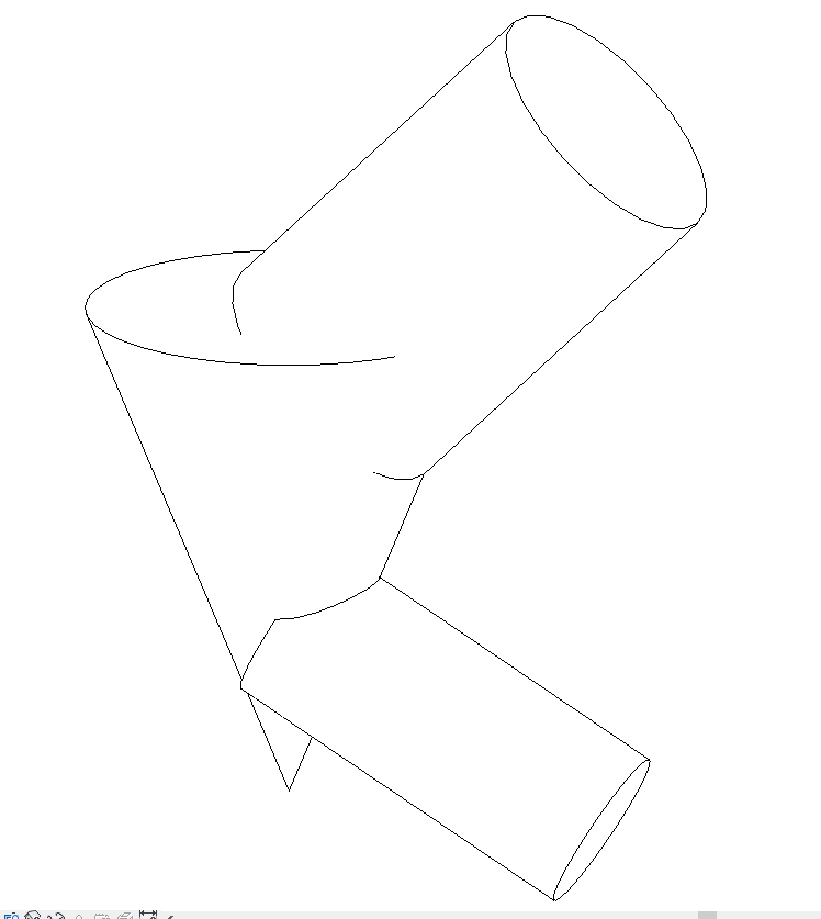

I'm assuming you are trying to MOVE the cyinder as to your third image. Which case, marmiketin1 want is quite right, its simply to small a distance for Revit to manage. This is indicated by the "no" symbol (circle with a line \ going through it). If you move an element with this symbol visible it will return the error "Element is to small on screen". This will occur whether you moved an object 0.3mm to 1,000,000mm if that symbol is visible!
Anyway, marmiketin1 is quite right, but the other method I wanted to put forward is to move the object so that the "no" symbol disappears and then you can type in 0.122mm and it'll move by that amount as well.

Thank you Elnazer2, Marmiketin1 and Shatner86, I got it. Thank you for clearly explaining which I understand you perfect. I am happy to solve this problem.
