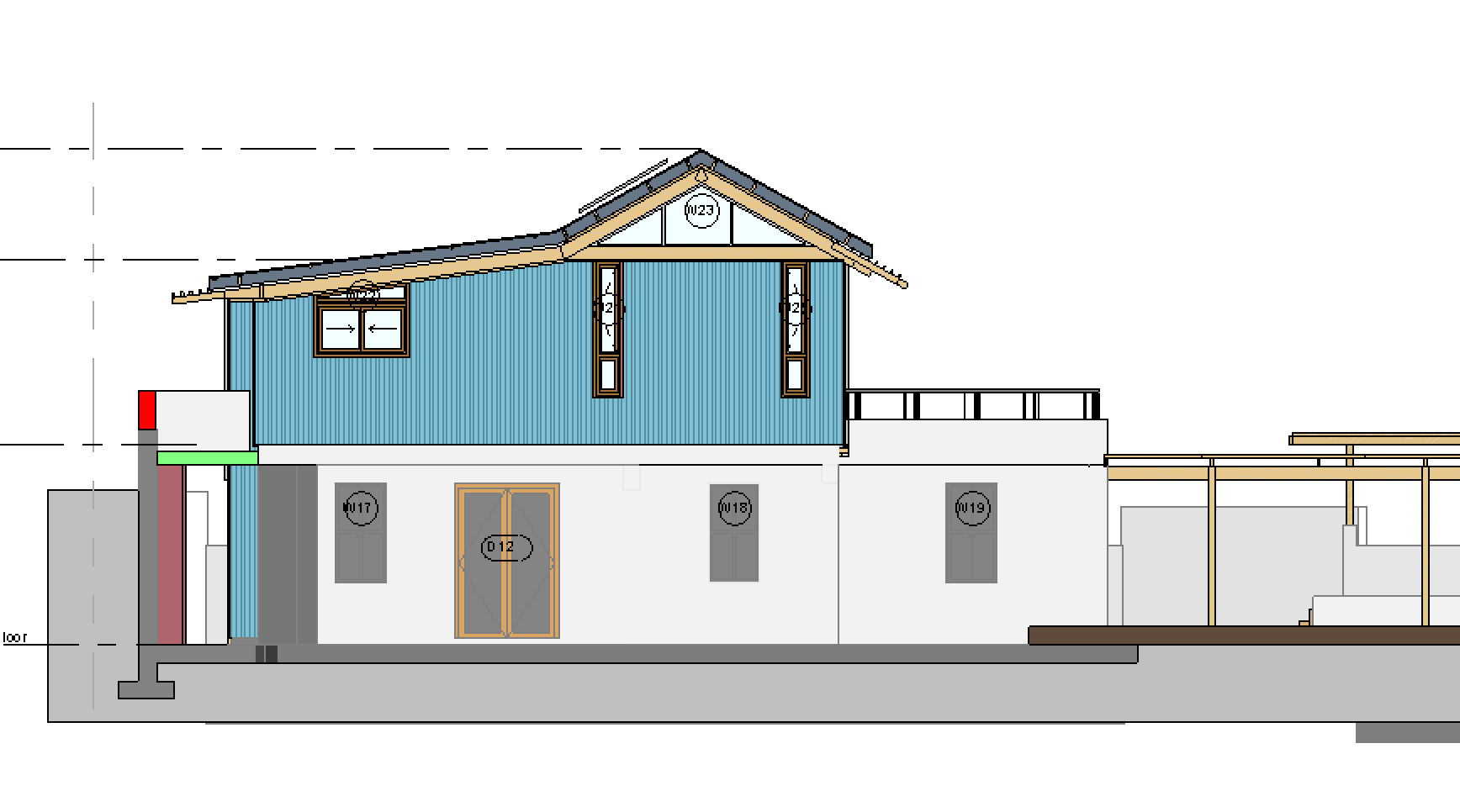

I am having a problem where in one of my elevations, all materials in a family appear as a dark grey. They are phased existing, set in an existing wall. By messing with the material appearance settings I was able to make the frame of the door appear, but no luck with the other materials or families.

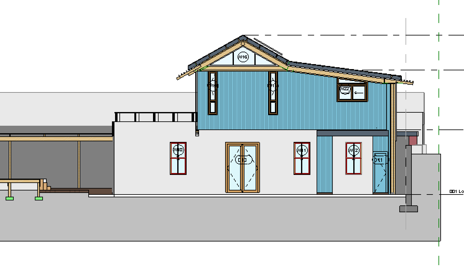

This problem does not occur in other elevations.
146757_Screen_Shot_2016-08-11_at_10.17.01_AM.png146757_Screen_Shot_2016-08-11_at_10.17.32_AM.png

Use show complete view setting.

There is no material assigned either to the category or to the object (glass) in the window family.
