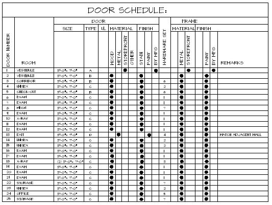

Can someone please tell me what parameter I need to use to add the room name to the door schedule. Please see attached photo. This is how I did it in CAD.
Thu, Aug 4, 2016 at 11:46:20 AM | Adding Room Names to Door Schedule
When you setup or modify your scedule look down at the lower left of the parameter options there.   You will see a drop down where you can add room data - to room or from room.
