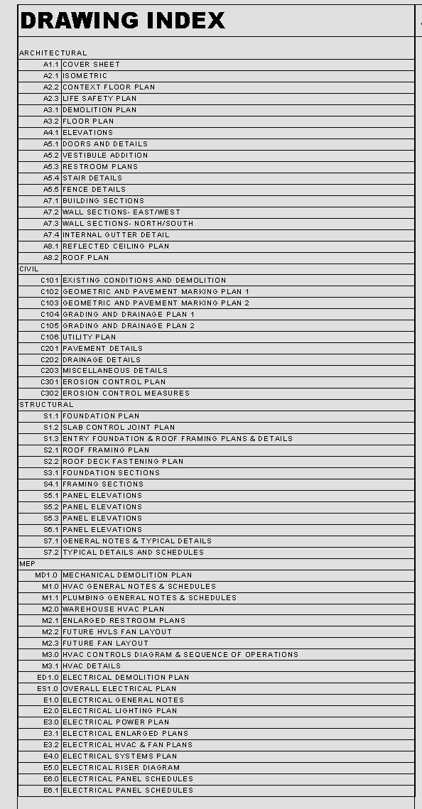

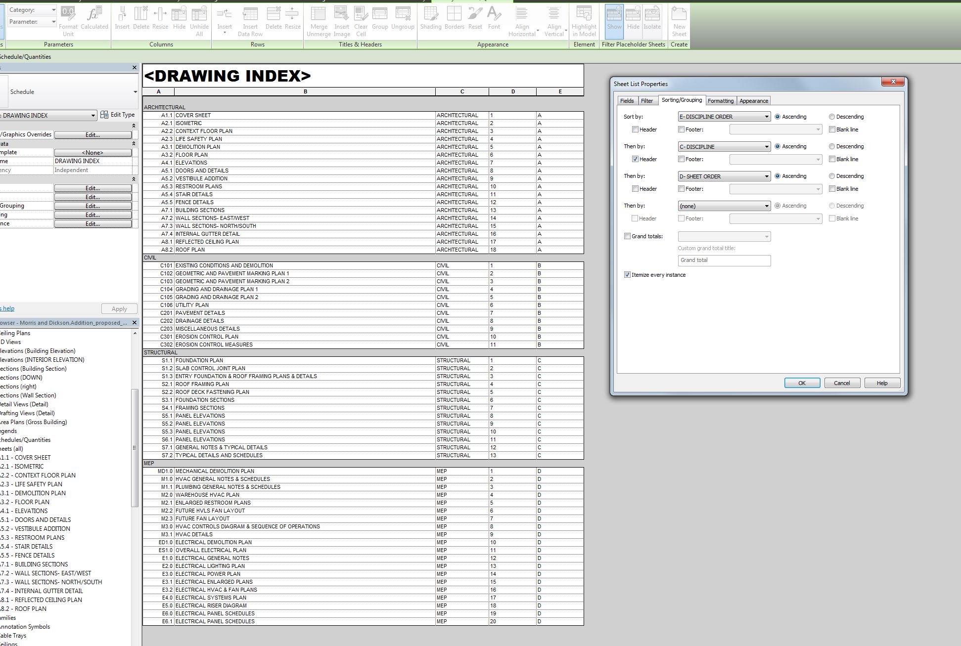

Hi all, I've been using placeholder sheets in my schedules to list out consultant drawings that will be in the set after the actual architectural drawings. In the referenced images, all sheets except Architectural are placeholders. I put together a new field so that they are first organized by displine order (E), then by displine (C), and finally by sheet order, (D). Adding a header to the Discipline field allowed me to break the grid and have a displine name at each change.
Does anyone know if there's any way to control the text size and type in those intermediate headers? Or location?

under the appearance tab you have the option to change both the header and body text size and properties

although those intermediate text lines are considered "headers" within the Sorting/Grouping tab, the "Body" text style controls their appearance, and there doesn't seem to be an override option.

Hmm well then the other option is to make each disipline a seperate schedule and then just line them up by placing them on your sheet.
