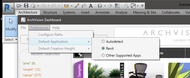

Hello!  I am having problems taking .rpc files i downloaded from archvision and getting them into my revit file.  I've tried the drag and drop method, and making a new rcp family but they both come up with the same error that the file cannot be loaded.  How do you take the .rcp file and make it into a family recognized by revit?

Do you mean a point cloud file? Go to Insert Tab > Link Point Cloud file and import the point cloud as a link. Hope this works!

Try changing your default application to Revit from the preferences tab in your Archvision dashboard. This will enable the drag and drop feature. See attached.
