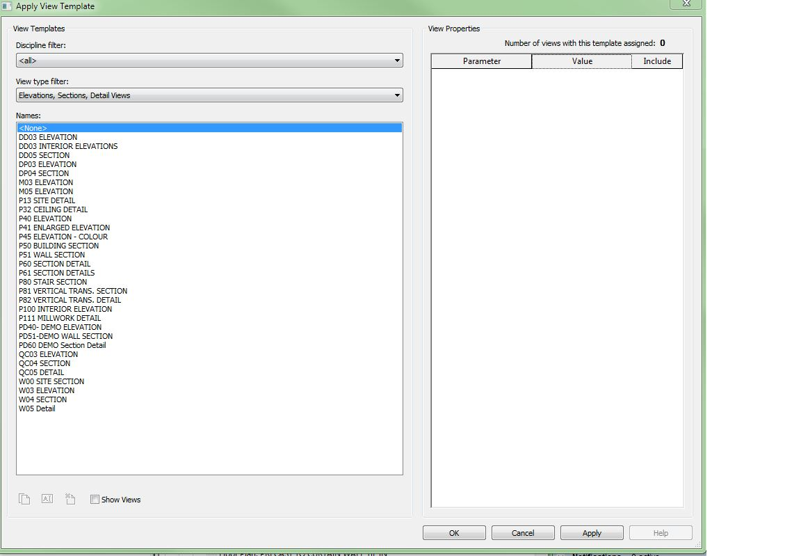

Good day. I have searched this question and no answers yet. We have custom view templates assigned in our rte.template files and in our projects since Jesus wore short pants. No issues except today
For some reason one of our VT is reverting back to none after it is selected.
The VT properties display in the view and behaves correctly. When the same view template is selected again in the same view in the actual apply view template pallete it reads none. Everytime no matter how many times we select and apply.
Cannot figure this one out.

Okay I researched this and here are some possibilities.
  • The linked model no longer exists
  • The linked model changed from custom to by host view
  • the view you are linking to in the arch model no longer exists
