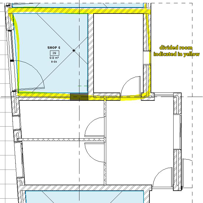

All room tags were already created for all rooms. The client then decided to divide on of the rooms in 3.
When trying to place room tags in the new divisions of the room Revit won't allow me too - the spaces do not highlight blue. The old room tag is still present in one of the divisions of the room though.
Can anyone help me with this?
Thanks!
Fri, Jun 24, 2016 at 7:21:10 AM | Can't create room name in revised room
You have to add a room before it can be tagged.
