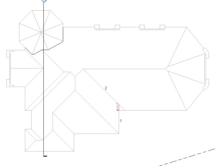

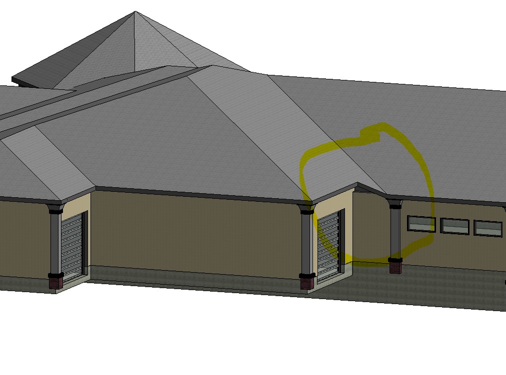

I can’t figure out how to make my roof do what I want it to.
In the image: I want roof line 1 to extend (like the magenta line) rather than roof line 2.  As well the roof face 2 will have to extend underneath roof face 1.  Any suggestions?

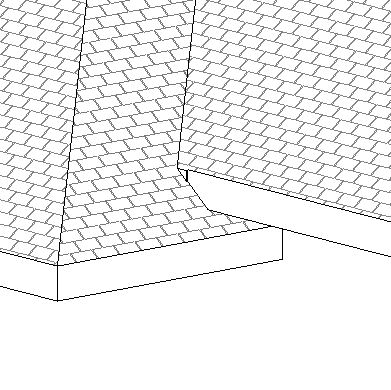

See if you can follow my advice in this thread:  It will ghet you the attached image.
