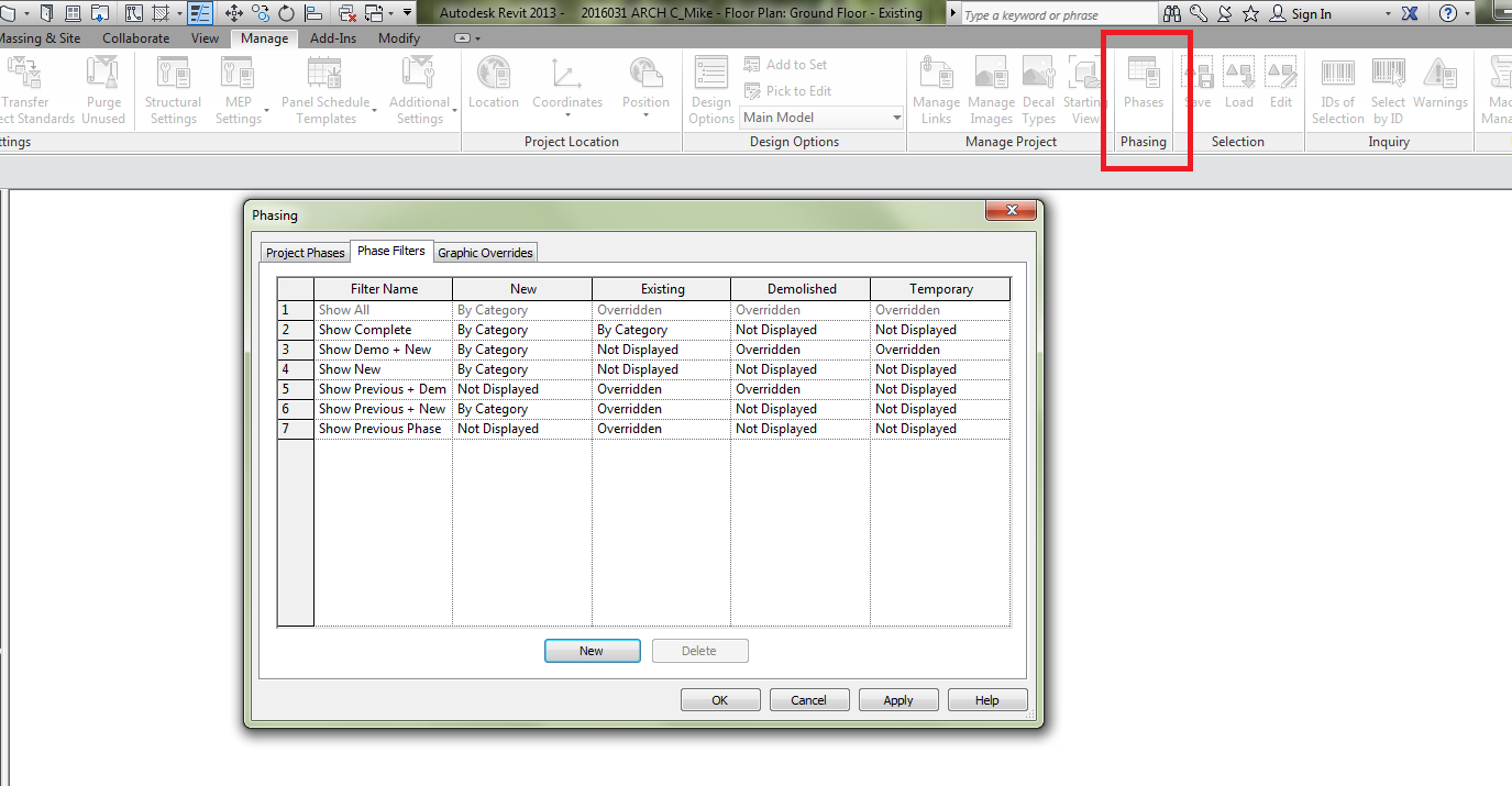

under the manage tab if you click on phases you can control how model elements are displayed for demo elements
