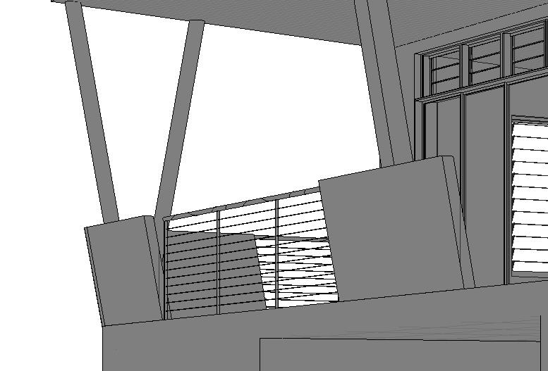

Hi guys,
is there a way to make a raked railing? Basically I would like to make it at same raked angle like solid fence nexto to it (see image).
Many thanks

you can do this by creating a baluster family to get the posts at the correct angle and then adding all the horizontal elements with offsets so they align with the balusters at the correct height

I made a railing type in the test project i attached. You have to delete the top rail element that appears once you sketch the rail as you cant have the top rail element offset. Hope this helps and gives you an idea of what to do.
Didnt realize the upload hadnt worked since my file was a bit too big. purged it and uploaded it again

thank you mate
