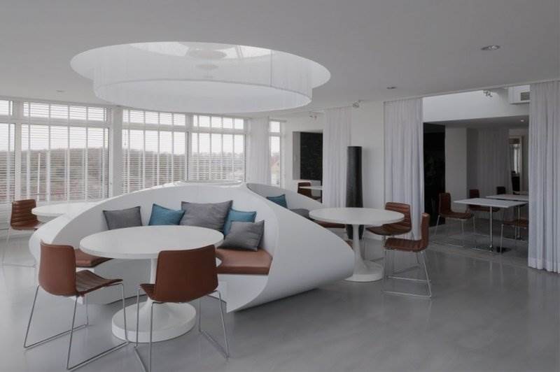

Hey could you guys please help me design the image below for an Assignment im doing in class and is needed for my design.
I would really appericate the help thank you.

Create a floor, ceilings (with circular high level bulkhead walls), external/internal walls, curtain walls to suit architectural design.For the pillow chucking just get a list of all the furniture you used and visit their manufacturer websites to see if they have them available in Revit Download them and drop them into your model.For Furniture that you cannot find supplied by the manufacturer, search through Revitcity for items similar and amend them to suit. For example you will find a curtain in disabled shower/ toilet families and cushions in bed families that can be used.The circular table is just a simple revolve form that can be created as a separate family or in-place family.You can use a wall at high level to represent that circular curtain.
If the large central white seating unit is bespoke, you will need to create an inplace or separate family for it. It looks like it will be easiest to revolve a form 360 degrees, then use voids to cutout the central recess and 3 x seating recesses.
