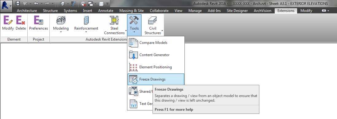

Have you tried the 'Freeze Drawing' tool?
Fri, May 13, 2016 at 12:31:57 PM | Converting Model Views to Drafting Views
Essentially the freeze drawing app simply exports to CAD which you can do manually.   The problem is that it is a CAD file.   If you explode that in your project, you get all the CAD crap.  If you want to create standard Revit detail, clean up these files in a program by revitizing them, then save the detail.

Thanks for both.
That is what I am looking for, to avoid the CAD craps.
Also, I will be able to create some isometrics from 3D views with proper Revit materials Cryingnot CAD 3D) into our detail library, which is the strength of the Revit.
