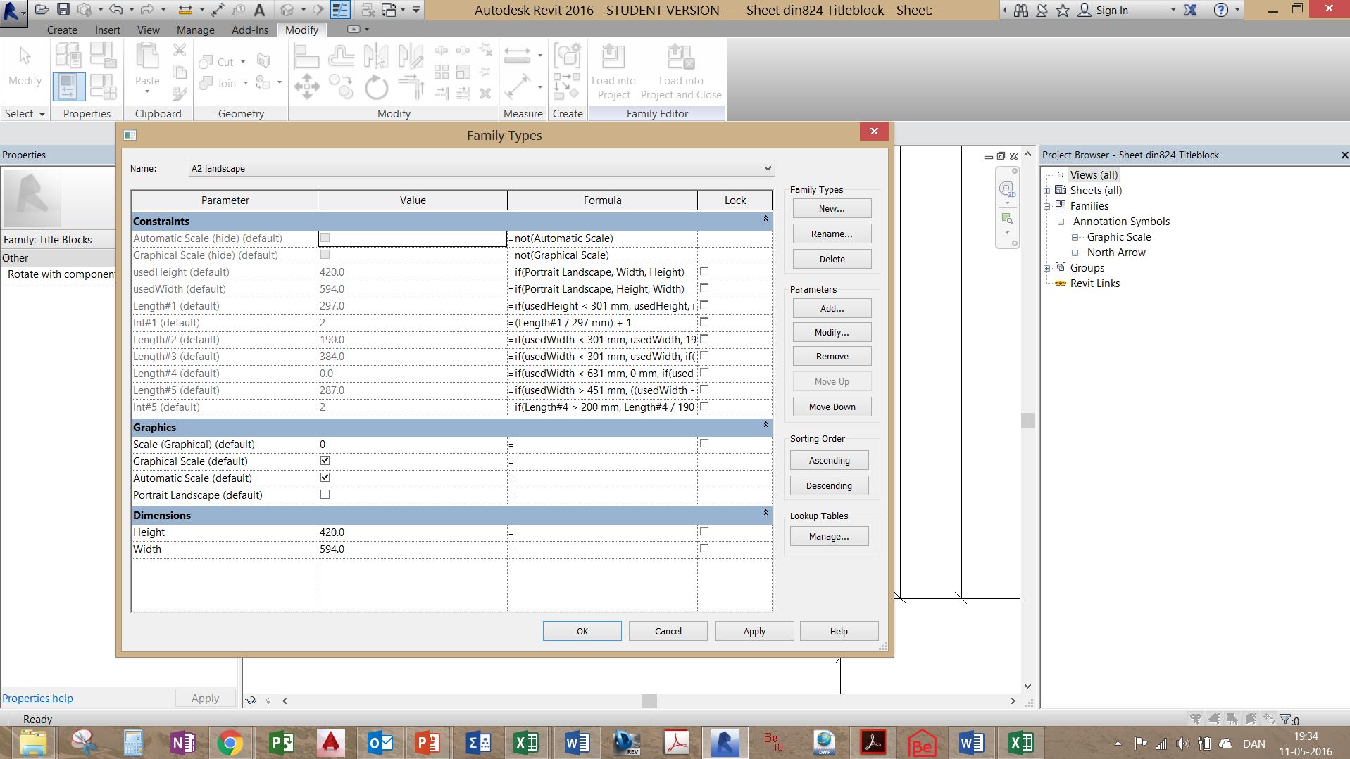

Anybody know why my scale in my titleblock don't show up in my Revit model.?
In my family there is not problem with the visibility, and when i open the type propperty in the family, the scale is set to "hide" but it is not posible to  to change it,  due it lock. any suggestions what to do ?

Is your visibility parameter for your graphical scale the parameter you have set as "Graphical Scale (hide)"? This would be locked because you set the parameter to be a formula... Perhaps your formula is incorrect.
