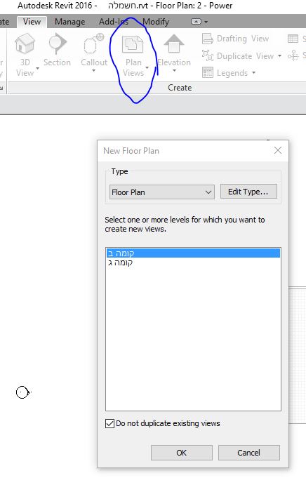

But now, after i have the right Levels on MEP model, i don't have the VIEWS for the levels copied from the architect model.
They exsist. i can see them on elevation, but not on project browser.
Guess i should create a plan view from each one of the levels copied? how should i do that?
thanks again for all your help.

Ok i think i found it.
Hope i'm on the right track Smile
