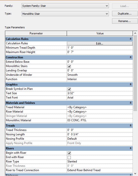

So I am trying to change the cut line of my stairs and see in many posts to do this in the type properties (in the Graphics sub section). However, when I go to the stair type properties, there is no option to change cut line symbol (only turn it on or off). Did this get removed in Revit 2016 (because that is what I am working in) or is it something else that I am missing?
Screen shot of stair type properties included.
Thanks anybody!

Only available in stair by component.

Oh, because we would only want to change this if it was a stair by component, hmmmmmm.
Thanks WWHub!
