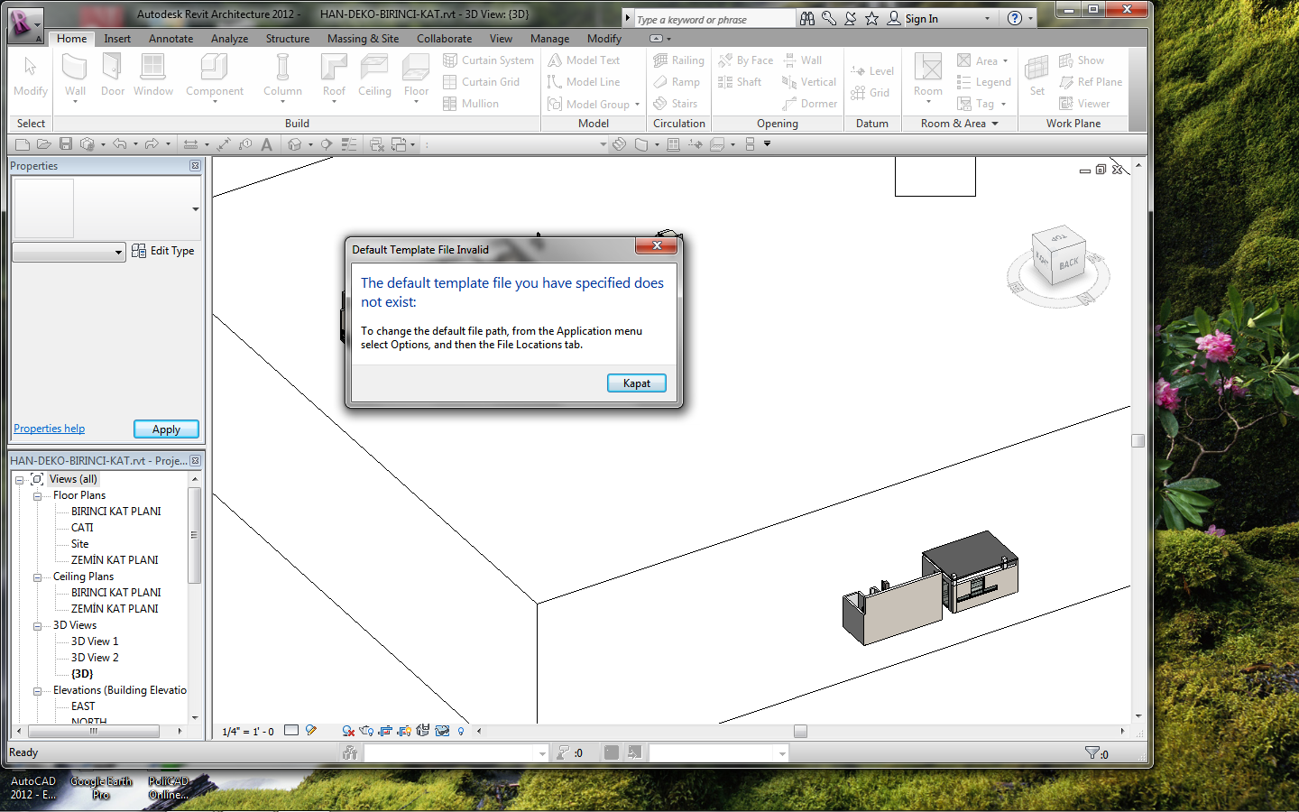

I am having problem with my file path. i attached the file how it says on screen. how can change it and where should be template files.

The template files are in the library where you saved them during the install.
The message you see on the screen refers to the Revit options that you find by clicking on the R in the upper left corner.  Pick options, then you can set the correct paths to your files.
