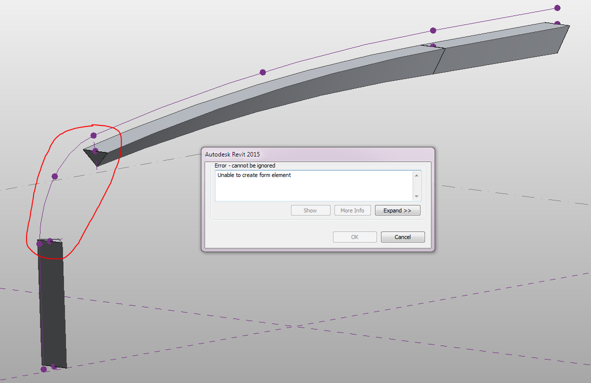

I hope somebody could shed some light on me. I was trying to create a triangular form which will be later on divided to create a truss. However I'm getting an error when I sweep the corner-top part (pls see screenshot). I have attached the family as well in case someone would want to take a look at it and point me to right direction. Thanks in advance.

Depending on the profile, profiles work best when on the ouside of the path.   The need to have the ability to form and an outside path doesn't always let that happen.
