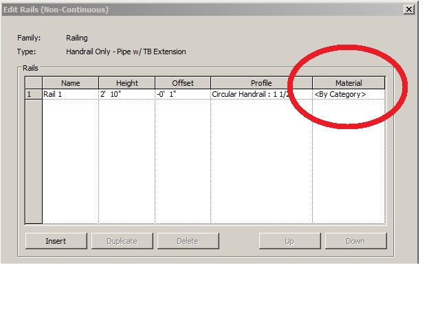

I can't seem to find any way to work with the material editor with railings.
I really just want to change the color.
Thanks for any help.
Gary
Thu, May 5, 2016 at 9:30:10 AM | Change material and or color on railings
See image
