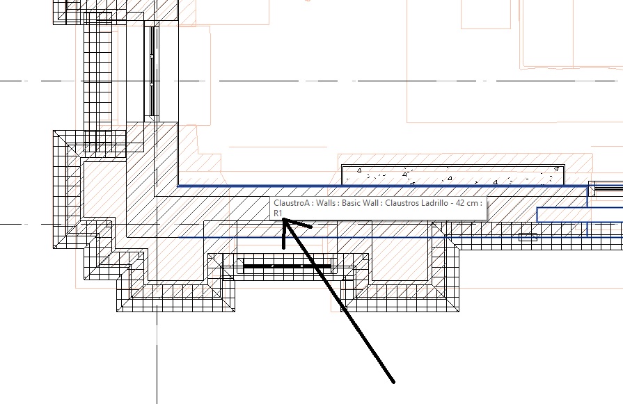

does anyone know (Mr. Hub) what does this code mean?
Wed, May 4, 2016 at 10:36:54 AM | entity code unknown
Since this is the wall type, I assume you are only asking about the R2 - correct?
You should have stated that you are working in 2016 - correct?
This last part of the element identity appeasr to be new in 2016.   I have not yet found what it is for sure but I am assuming Autodesk has added this to identify the special wall join controls that is only available to subscription (and student) customers who have the R2 package.

I just noticed - yours is R1.... still same answer except you are not on subscription.

but floors also have it. And in the same model some say R1 and others R0
