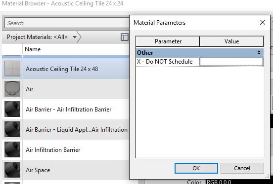

Hi everyone.
Has anyone tried to transfer materials between projects (using material libraries) with custom parameters added to material? It seems that information added to custom parameter stays in the projects and is not saved to library, so when I load material into new project my custom parameters have empty values. Does anyone have a solution for that?
What I could do is to transfer materials using Transfer Project standards, then those values are copied (only if material is new. if I overwrite it, then values don't fill). However this way is not very good for me as I have to transfer all materials from source project and I can't choose which I need, like if I would load them from material library.
Thanks.

Wed, May 4, 2016 at 10:28:10 AM | Material Library with custom parameters.
My initial answer was correct for material transfer which was your question.
The material property parameter fields are system level.   You can not add or remove fields, you can only change their values.  You don't say what fields you would want to add so the question is incomplete.   I would have thought that what is supplied is adequate if you start with the correct base material to begin with.
The other possibility, as I referenced is shared parameters.  These can be added to your template for the material category but the problem is how do you assign the data to the associated material.   Here is a process to do that.  Have your material in the template and add a shared parameter to project for the material category.  Create a holding model group that would have these materials assigned within the group.  Schedule a material takeoff that includes thie field and fill it in for the materials.  Now delete the group instance.   The properties assigned to the materials is now in your template.

Thanks for the answers. Shatner86, I'm aware of how to add those additional parameters. I was looking for more convenient way to transfer those parameters between projects. I need to create material library for some company but they want to keep more information in it that system parameters allow. Seems that I will have to have project template and shared parameters file together with the library, also provide additional instructions how to use it. Thanks for your time ;]
Fri, May 6, 2016 at 3:36:29 PM | Material Library with custom parameters.
#9
I just noticed that in 2016, Project Material Parameters now show up in the materials dialog.
