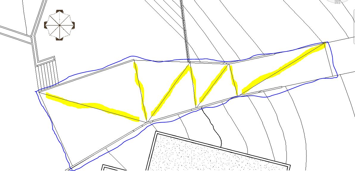

Hello friends!
See attached image. In short, I modified a floor slab to follow the slope of the topography. Wondering if there's a way to remove/hide the diagnol linework developed through that process.
Thanks!
PS: In the image, blue lines are the edges of the slab, the yellow are the lines I'm trying to hide/remove.
Wed, May 4, 2016 at 7:28:26 AM | Removing linework produced when modifying subelements of a slab
Try turning off interior edges under floors in VG.

Hit VV to bring up visibility graphics over-ride window go to Model Categries Tab - Floors - Turn off Interior Edges.

You guys are awesome, thanks!
