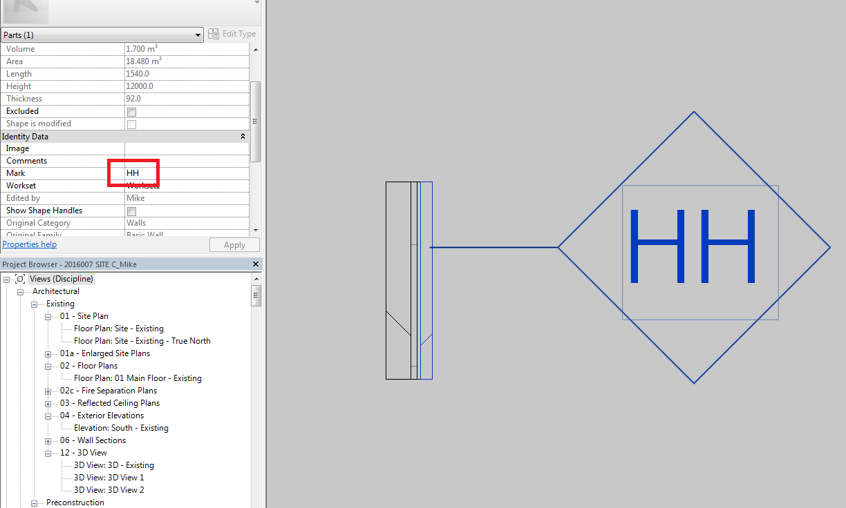

Just a brief description of whats making me pull my hair out. within my model, each wall type has an NBS parameter with the NBS reference typed in. Some of my walls have been made into parts to cut them around steels, make cladding protrude further, create asthetic openings etc. The problem is now they are parts I can't tag them for the NBS reference for that wall type in my sheet views. I thought about showing both original and parts in the view but this would cause more confusion on site. ultimately i have to show them as parts. Also looking into if its possible to tag a hidden item (eg i could show both and hide the original if i could tag it) but not having much luck with that either. Any work arounds or tips would be greatly appreciated.

I don't know if this is still open, but I just found the answer. If in visibility setting you select both you can tag the wall assembly and still show the parts. It's working for me so far.

You just need to create a Parts tag by editing your typical wall tag, saving a new copy and changing its family category to parts tag as well as change the label to be associated with the mark parameter. Then enter your info into the mark category of your part and when you tag it the info will show in your tag. you can then use that to tag the different parts and it will look exactly like the wall tag.

Heres the tag itself

thanks palowe, unfortunately that wont work in this case either. showing both will show walls cutting through items they shouldn't which is why they were made into parts in the first place. Would let you tag but would cause more confusion looking at the view. marmiketin1 that sounds like a good solution. The family you uploaded is in a newer version of revit than mine (the project is in 2015) but think i can follow what you outlined. The only concern is the info i want the tag to show is already in a separate wall parameter. Ideally i want the tag to refer to this rather than the mark value otherwise I'd have to go round each wall and put that information into the mark value. Plus I'd have walls with duplicate marks which may cause issues identifying walls down the line. Will post if i can get that to work though.
