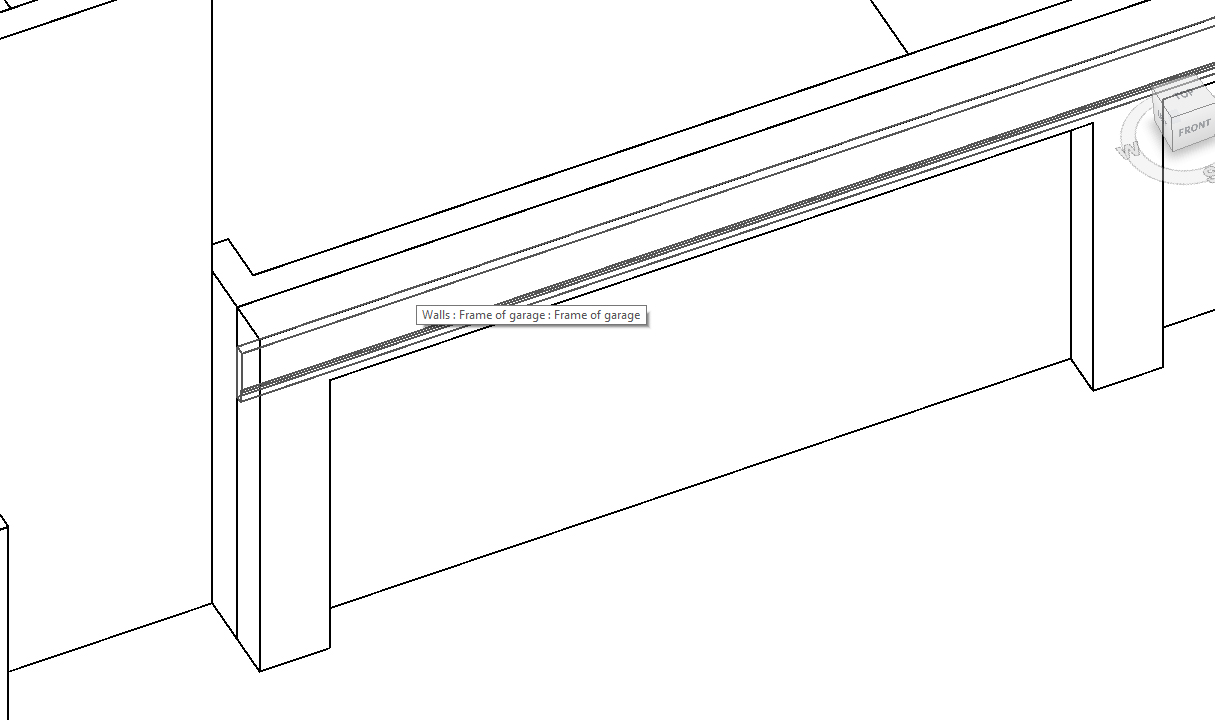

Good day,
I add Extrusion wall frame of garage and then Wall: Sweep (Architecture/Wall/Wall:Sweep) on the Extrusion but Extrusion doesn't host Sweep? How can I solve this problem?
Please see attached picture.
Let me know.
Regards,
Bogumil
Tue, May 3, 2016 at 8:06:49 AM | Wall: Sweep on Extrusion wall
Don't use an extrusion if this area is really a thicker wall....
 or
Don't use a wall sweep, do an in-place sweep.
