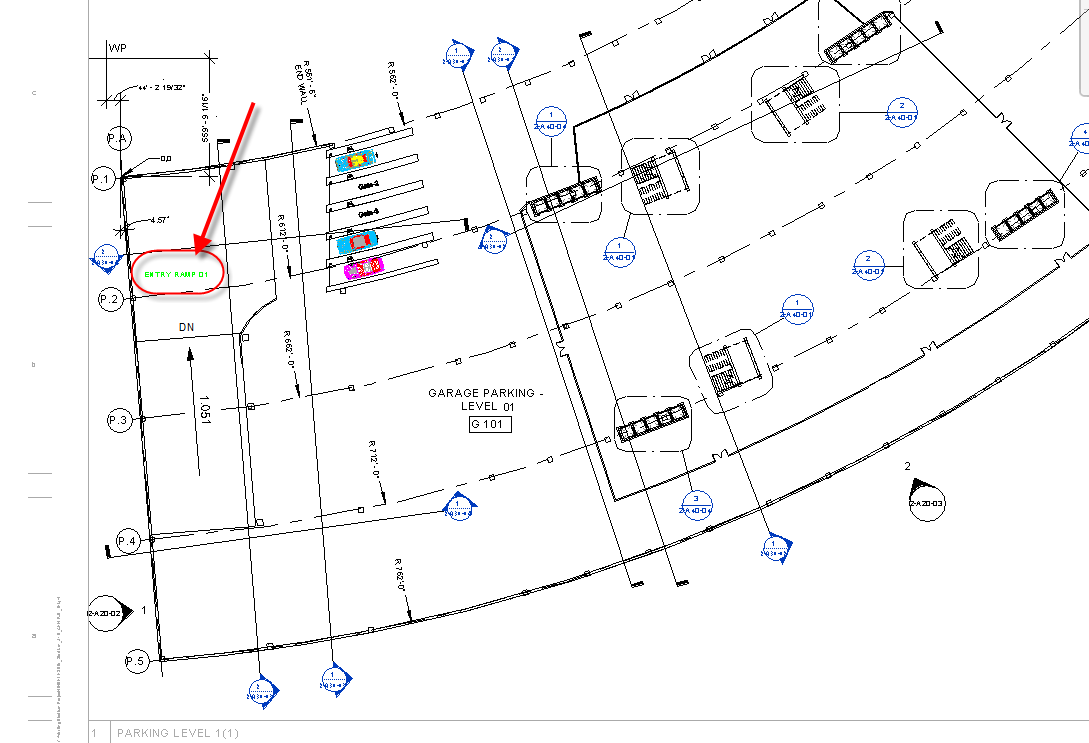

Hi guys,  present  I'm working multi level garage building. In this project i created  many ramps from level to level. but i feeling difficult to create a RAMP TAG ( BY THE RAMP NAME ) really i want ramp name on ramp tag  Crying i.e. Entry Ramp 01 and  Exit Ramp 02 ) and same thing in schedule . I never seen ramp tag family template for the name usage and i tried generic annotation family template but it's not taken shared parameter. presently just i enter text for solution.  Please advise me guys...

The ramp tool is not working very well in my opinion. You can't tag a ramp, and they are uncut able in plan and it's difficult to use the spot slope tool on them. Ramps are for small wheelchair acces ramps not for level to level ramps, I always use a sloped floor for ramps in a garage building like yours.
