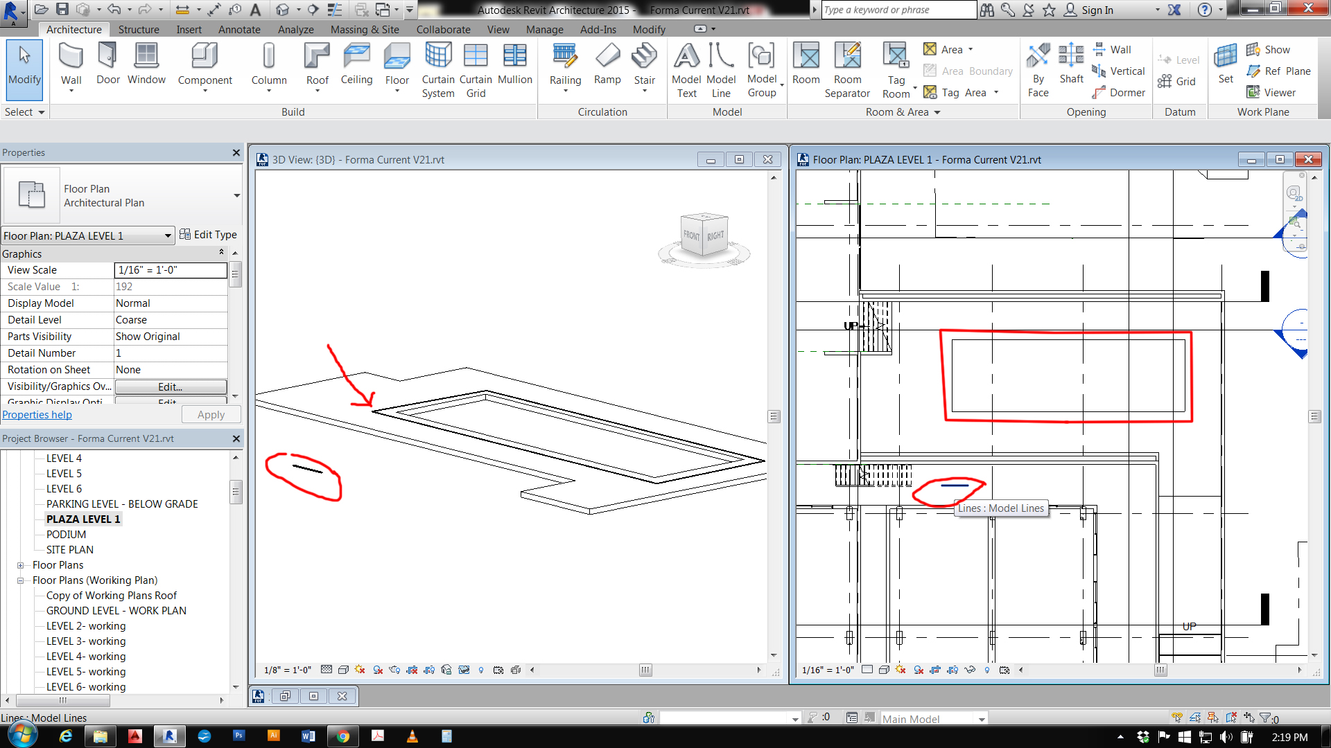

Ive drawn model lines on this slab. to look like the border of a pool. see pic. but in plan, the model lines do not show up on the slab, which is raised from the its host level a little bit. The host of the model lines IS the slab. they ARE model lines, not detail. In the picture. the circled line in red shows the model lines appear in both views, and VG and hidden stuff is not doing anything. so why dont the lines show up.?
Edit: curse. it was my view range. was just inside the raised slab. so slightly below the model lines on the slab surface.....gah! :-)

Nicely fixed!
