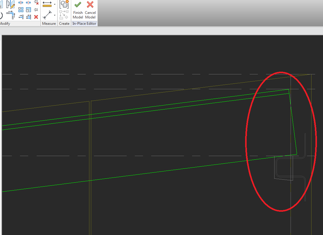

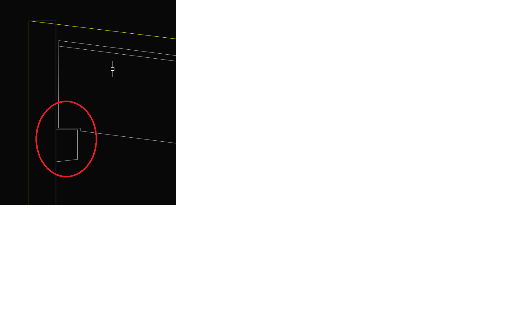

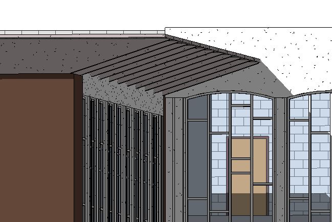

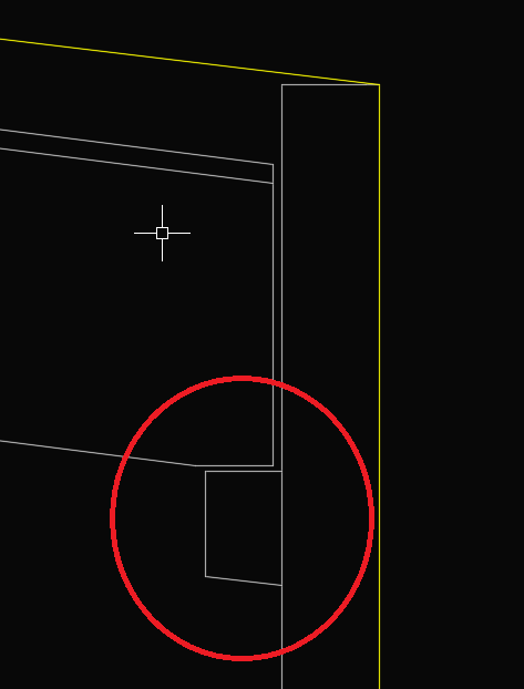

I'm using Revit 2016. I've attached two images showing the ends of a double tee that we had to cut down because of the extreme slope. This was done in Autocad. I was wondering if there is a way to do this in Revit. I've also attached an image of what I have done in Revit so far. I have not figured out a way to model these tees as they need to be. Any help will be appreciated.

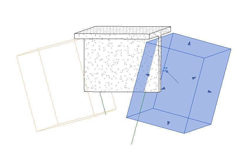

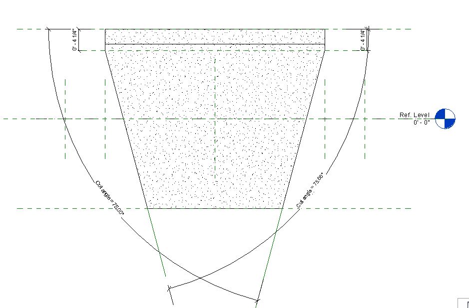

I'm working on an older building where they used exposed single tees with clipped ends - see image.
So I modifies a single tee family adding a void with its angle controlled using a reference plane.   As you can see, I had one on each end for this application.

This might help.
http://www.revitcity.com/forums.php?action=viewthread&thread_id=31488
Wed, Apr 27, 2016 at 9:15:34 AM | Cutting Ends Down For Sloped Double Tees
CDWdavid,
As you can see, I wrote in that string about using a reference plane to cut structural elements.  But dummy me, in this case I did it wong and thought the precast did not work the same.  ... duh .   Glad you pointed this out.
