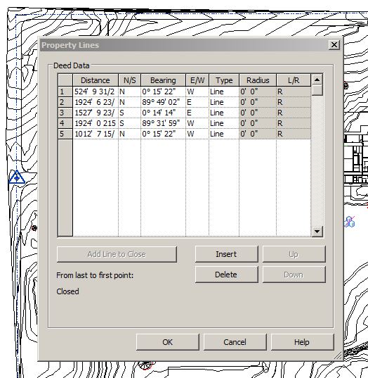

You said you had a site survey.   A typical survey has a base point, all property lines using bearings and distance, and it may include topographical information.  Under the massing and site tab is the property line tab.  Using that, you can lay out the property according to the survey.
I prefer to use the table because it is far easier to enter the data like the one shown below.
