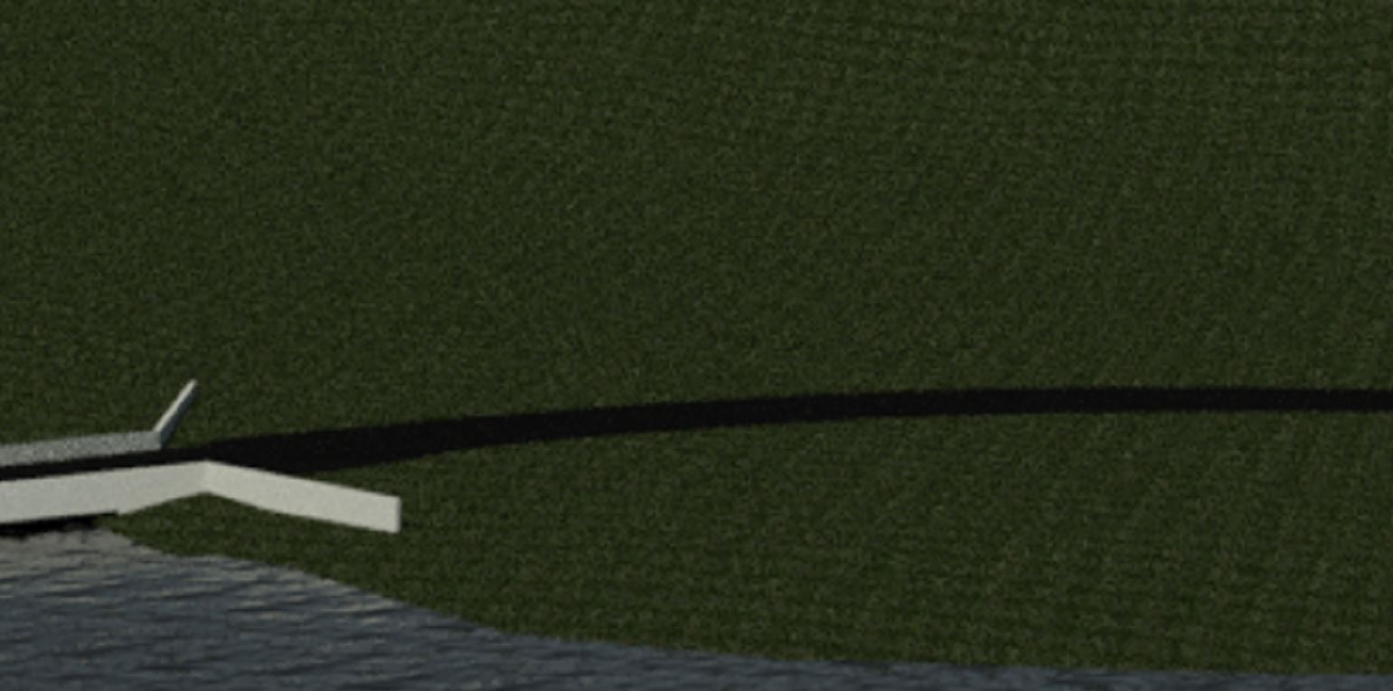

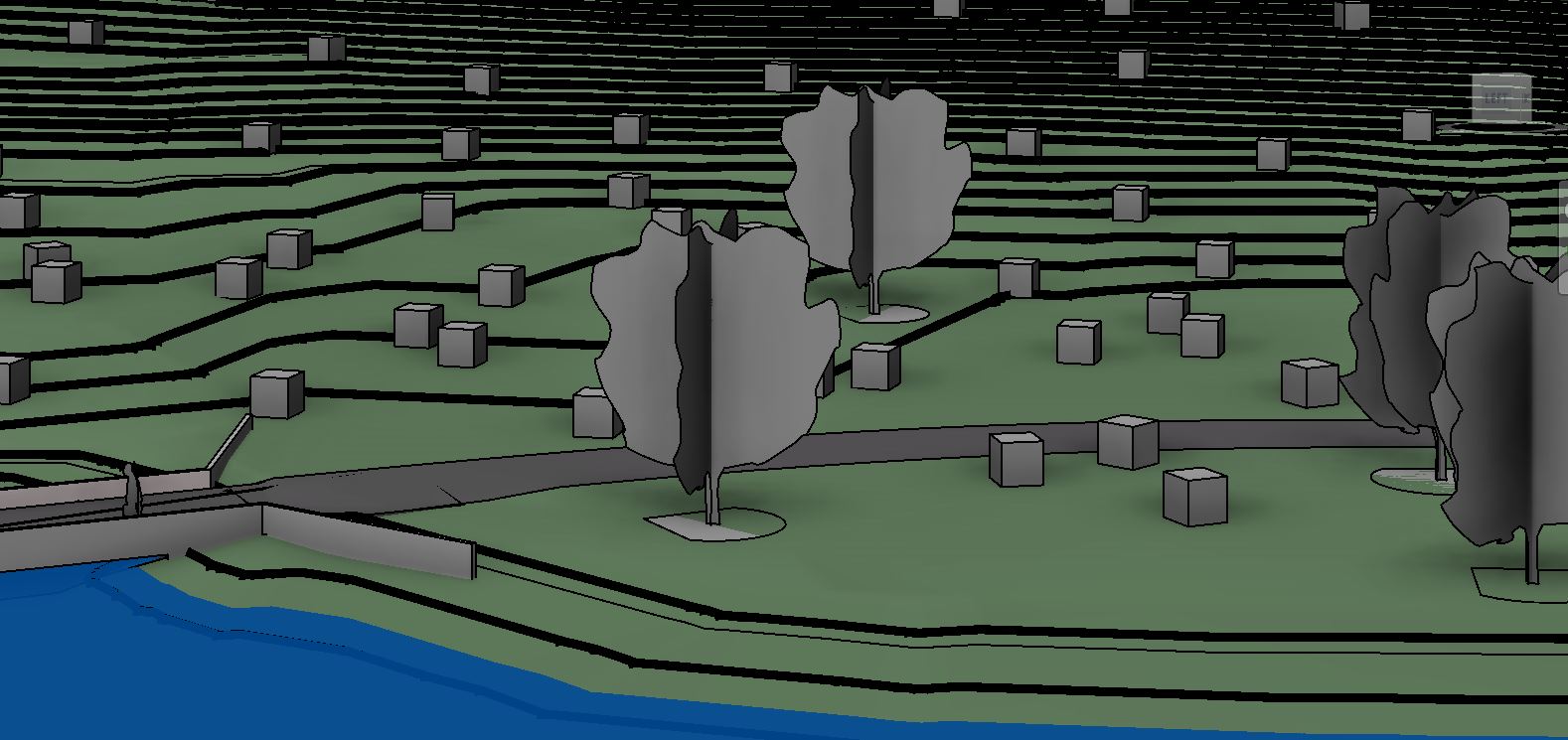

I just installed Revit 2017 from 2015, so I loaded a previous project to see the new rendering capabilities and none of the trees or people render, In fact most of them just show as blocks or cubes. I even loaded a new project and new families straight from the 2017 templates folders and I still get the same results.

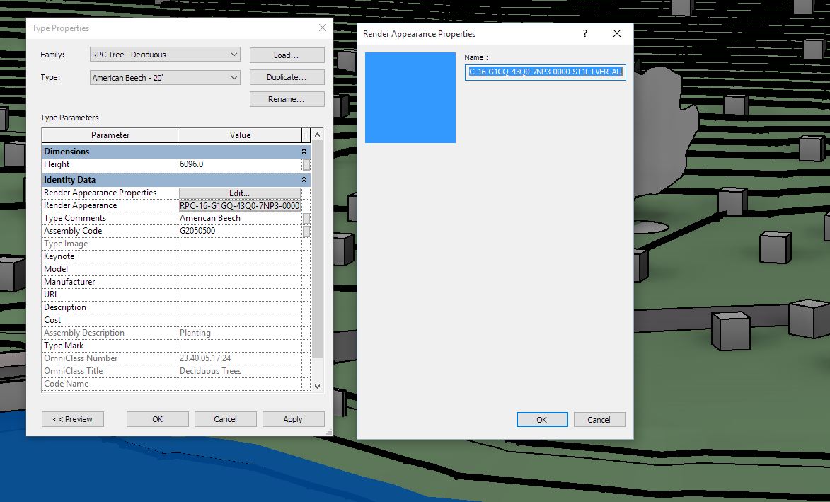

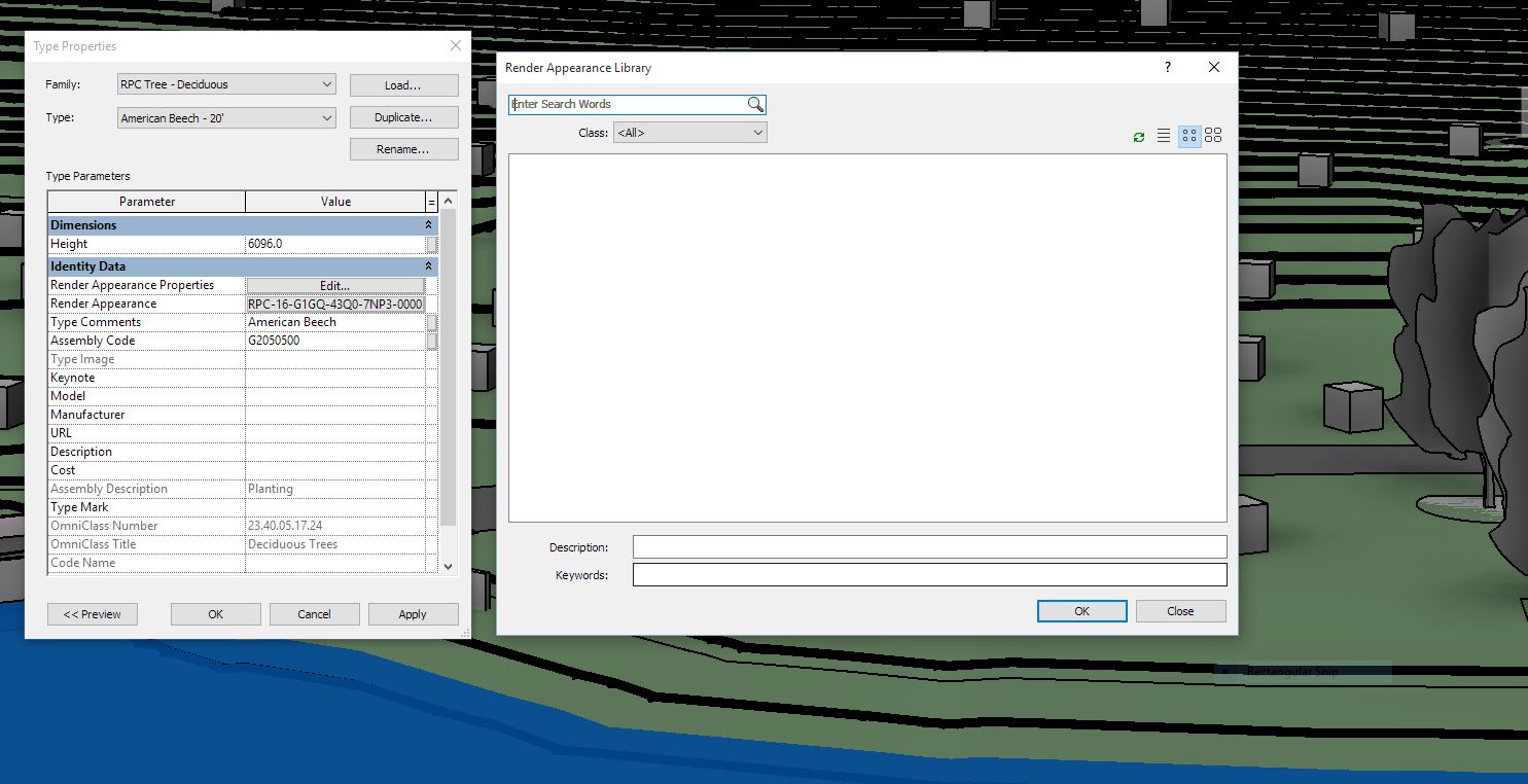

I installed Revit on a fresh computer and everything is working fine, I believe it has to do with running previous versions of Revit on the computer, yes I installed 2017 before removing 2015 I've attached files to help clarify things
