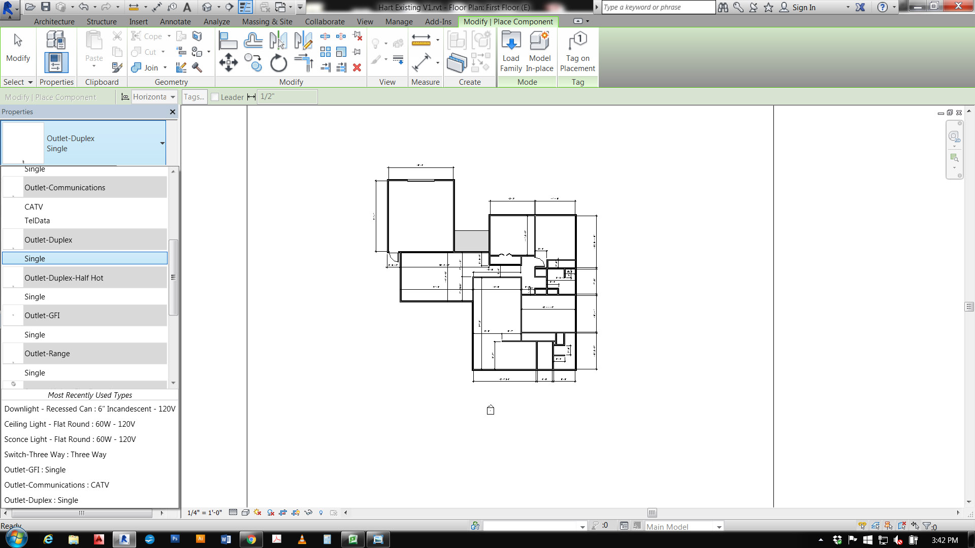

OK. took a file to make a new project. Purged out all i didnt need. there is a fuckin huge list of electrucal components in my components list. and it makes the list huge and I can't deal. But purge all down to nothing and still the elctrical components are still there (see pic.) how the heck can  Iget these out of my project so my sinks and toilets and stuff are easily found on the list. trust me the list is huge and unusable.
thanks in advance.
 Edit: found it. you can delete from the project browser instead of purging.

Are they on a legend?

you called it. Its there, without the symbols now since I killed em in the families list. But good call. DIdn't see it.
