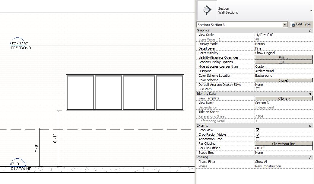

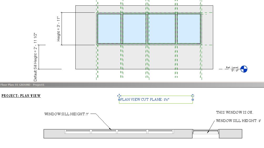

Mon, Apr 18, 2016 at 9:03:37 AM | Window Visibility in Plan View
No family was attached.

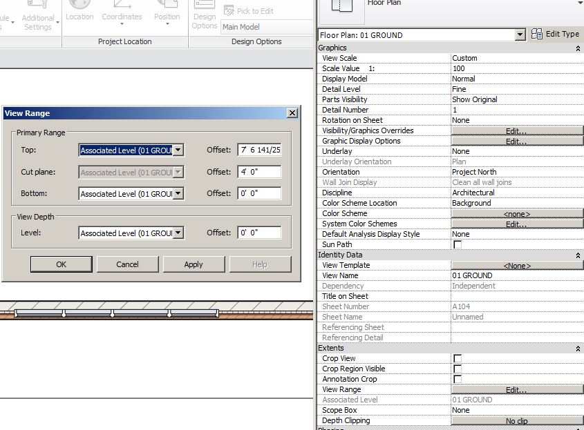

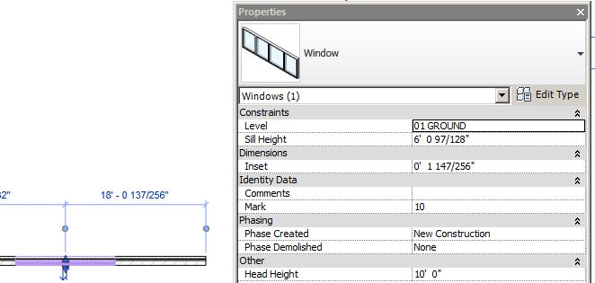

Mon, Apr 18, 2016 at 4:57:02 PM | Window Visibility in Plan View
#9
glenlake
Joined: Sun, Mar 11, 2012
25 Posts
3.5 Stars: 3 Votes
Thanks for the images. I still don't understand what's wrong.
Please see my view range.
