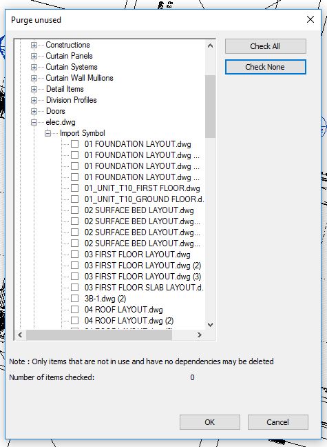

In my 2016 Revit model under Imported Catagories there is a catagory called Imports in Families that seem to contain line types and hatches that came from AutoCAD.  They aren't listed in "Purge Unused" and this project has no Groups. How do I find where they are in the model and change them to something else so that I can delete the Imported Catagory?

Someone has imported CAD into a family and exploded it!  Really BAD process.  You will have to find that family.

I actually found the solution> Somehow, all my previous DWGs were under listed under 'elec.dwg' and 'imported categories'. i just had to select and purge everything. and they are gone.
