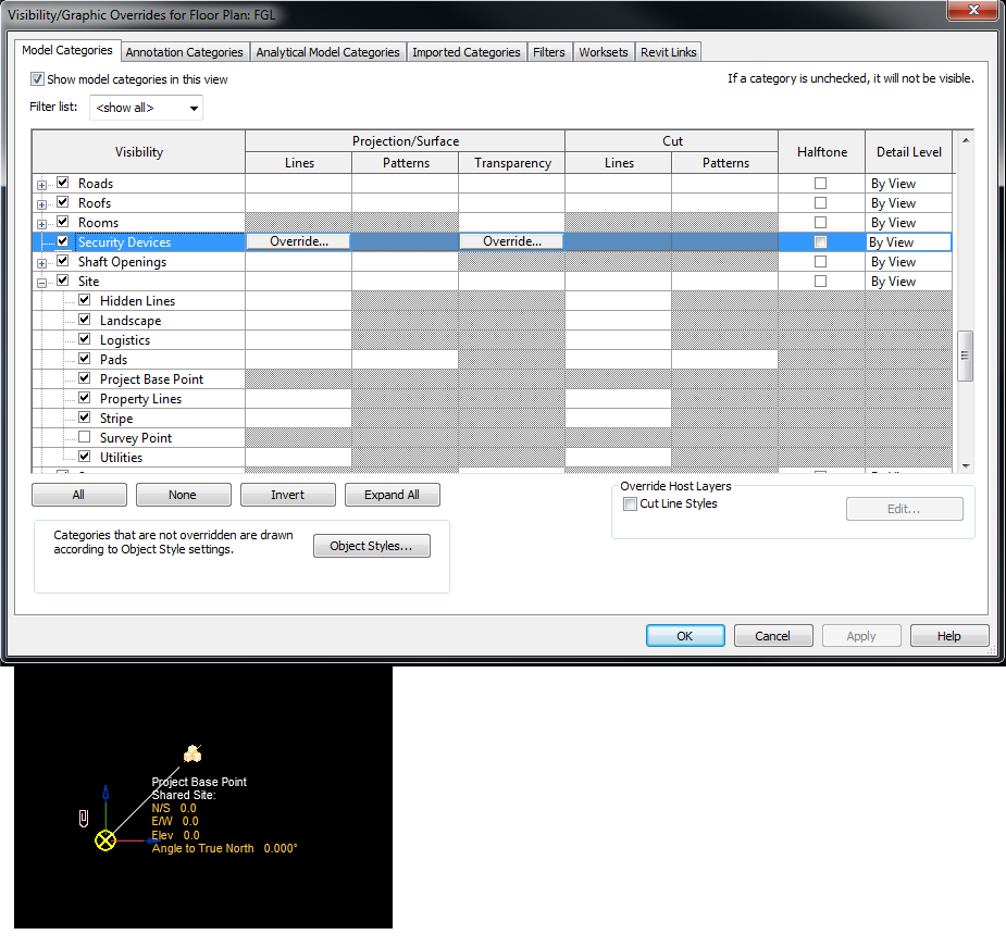

Active your Project Base Point

Thank You very much
I activated, still can not get.
Could You please explain further?

In the properties pallete change Orientation to "True North".
Then try to change the angle...
