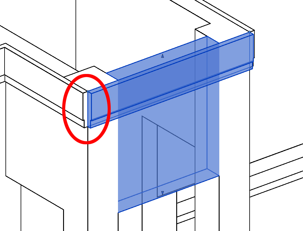

Hello there,
Do you know how to trim the sweep corbelling corner? Please see picture here. I struggle with it. Somewhere will auto join but some not. I don't know why.
Your help will be appreciated.
Kind regards,
Bogumil

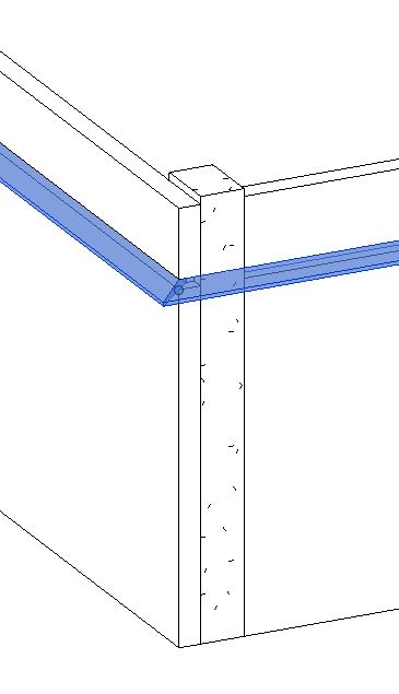

Do your sweep all in one by picking consecutive walls, not seperate sweeps.  The corners will then be correct.

Most I use sweep under Wall/ Edit Type/ Structure: Edit/ Sweep, and sometimes I use sweep under Architecture tab, click on Wall and then click on Sweep.
You see this picture, it is column not wall. Column not host the sweep, I have to pull sweep over.
I experiment what you said, It looks not successful. Maybe I miss something.
Let me know to how to solve this problem?
Many thanks,Bogumil

Don't do this in your wall - none of them.  Do them all as one wall sweep picking the walls one at a time then come back and drag that wall over the column.   Here is mine and it works just fine if you do as I directed.

I got it and it went successful. Very simple. Thank you for your tip and your time :-)
