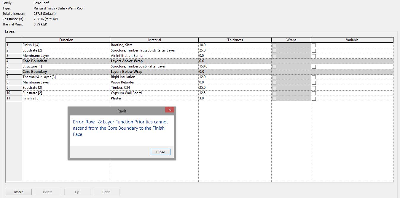

Hello...
So I think I have followed the protocols for setting up this roof... Obviously I've done something wrong as am getting the error which will not let me close out the detail.
I am thinking its something glaring [usually is] that i am missing...can anyone see?
Attachement below...
Thank you in advance.
Tue, Apr 5, 2016 at 5:29:05 AM | Rules for Assigning Layers on - Applies to Walls and Roofs
dvgareth77
Joined: Fri, Mar 20, 2015
0 Posts
5 Stars: 1 Votes
Solved!!!
Basically the figures attached to the fucntion within brackets [1], [2], [3] etc...have to run in order.
I had Substrate [2] below my Core Boundary Structure [1] which is an error...
My error...
