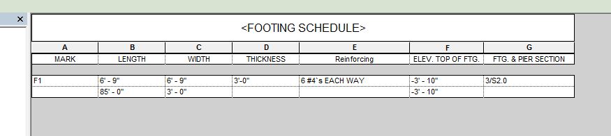

Trying to filter out or remove the strip footings from my foundation schedule with no luck. Only want to schedule Isolated footings.
Also in my foundation schedule, trying to call out "Elevation Top of Footing" as 96'-2" vs. -3'-10" as its appearing. My elevations are set up as 96'-2" for "Top of Footing", and 100'-0" as "Finished Floor". Anyway to have this consistant when populating in my Foundation schedule?
Searched these posts over and only seen where the question was asked but didnt see it get answered, thx!
See image

You can always filter by comments for a quick way to remove items from a schedule. As far as displaying the proper elevation, I'm not sure.

Filtering by comment worked, Thank you! Anyone re: correct display of elevation in the schedule?
