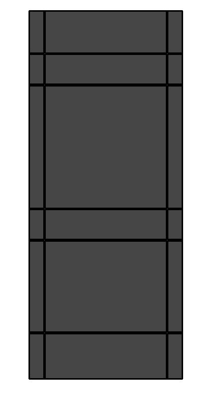

I recently learned a new trick of using a curtainwall to create precast walls. I set grid lines every 10' in order to make 10' precast sections along the curtainwall. I am creating a custom family so that the precast will have reveals in it. I started a new family under "curtain wall panel" template to get the precast to look the way I want. When I load it into my project and select the 10' wide curtain panel and change the type to my custom precast section, it inserts a panel that is 14'-6 1/2" wide rather than the 10' that I created it as and the 10' curtain panel I have selected. In the properties of the custom panel when selected even says it is 10 wide, but it is actually the 14'-6 1/2" width.
Any ideas why this is happening?

You are using a curtain wall....curtain wall panel sizes are defined by the curtainwall.
Although you can make curtainwalls work somewhat for panelized walls, I think this process is very awkward.  I prefer using normal walls and using a void family.   See my post here.  You can create a family to identify, tag and schedule each panel.

That sounds like a good method. However, I am not very confident with creating, loading, and using my own families yet. How would you create this void family?

Attached is the look I am trying to achieve for my panels. The reveals are 1" wide by 1/2" deep. I belive what you suggested earlier was a way to divide a wall into sections.
Wall family
