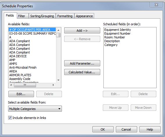

Hello, In our office we are linking in discipline models together in our architecture model.
We're trying to create multi-category schedules to capture mechanical, specialty, and plumbing fixtures.
We have no problem scheduling everything in our Arch model but as soon as we click "include elements in links" all of the filters in our schedule are removed.
We cannot schedule multi categories within a linked model.Is this normal?
Is there some kind of hotfix for this? I'm seeing something out there for 2014-2015.
Any help would be great!
We are all using Revit 2016

I do not think it is possible to apply filters to a schedule that includes links. I've encountered this as well when trying to create a door schedule that included two architectural models. Depending on how you intend to sort your scheduling of these items, I'm afraid you will have to create individual schedules for the items you are trying to display from the linked models. Or, have a parameter in each of the items that can be used to isolate a certain series of them. It all depends. Cheers.
